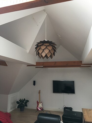

And, it can be very nice - I think :wink:

Shape and Color reminds me of a Pinecone - Very nide indeed! :thinking:
