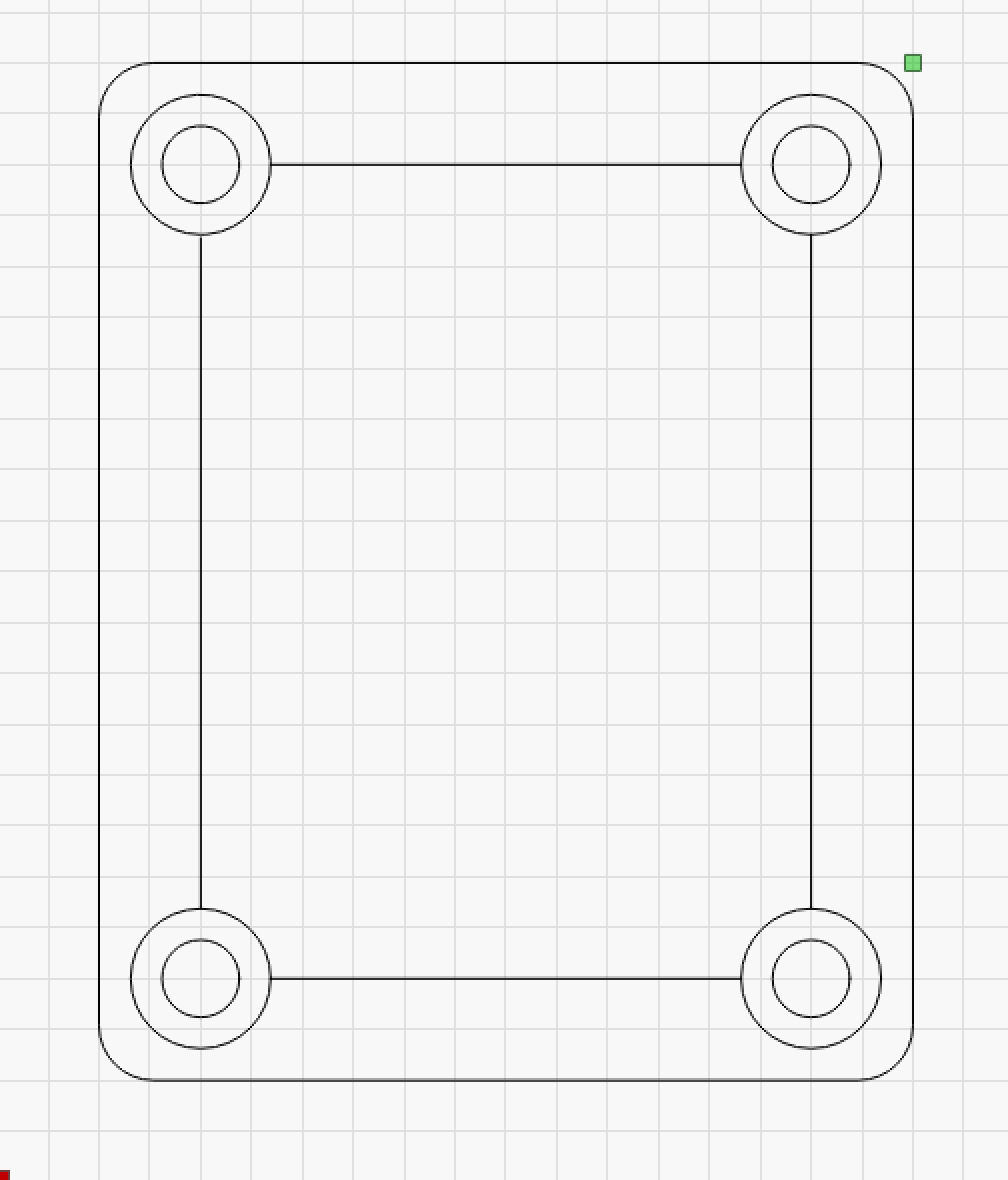

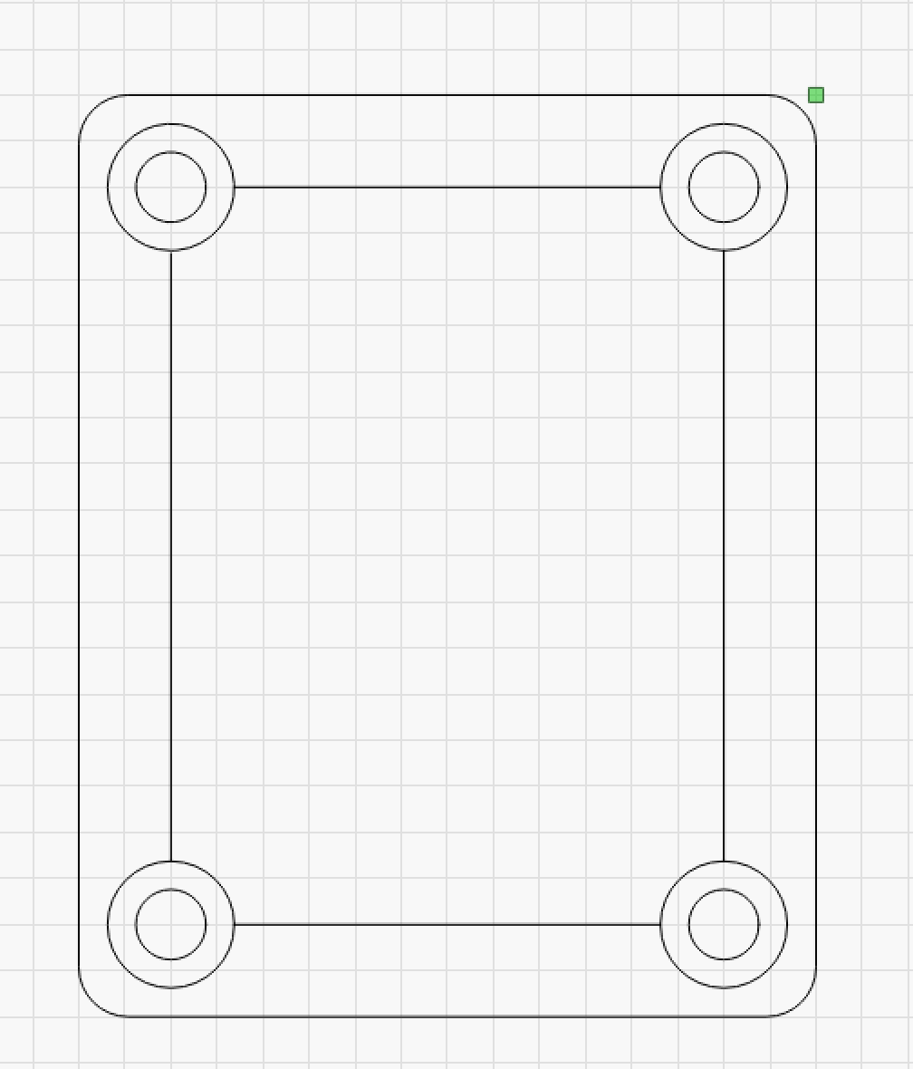

I’m sorry to ask, but i keep watching tutorial videos and they all say the same thing, but i cant seem to replicate the feature. This is a drawing i am making just to get familiar with the software. it is intended to be a simple gasket. the smaller hole is a through hole and the larger hole is to be trimmed at the intersection of the line and the circle.
I have selected all of the artwork and converted into a Path.
I have selected the circle and the lines and then tried to trim, but i can not.
I also tried to weld it all together and had no success. could someone give me a cluse here?

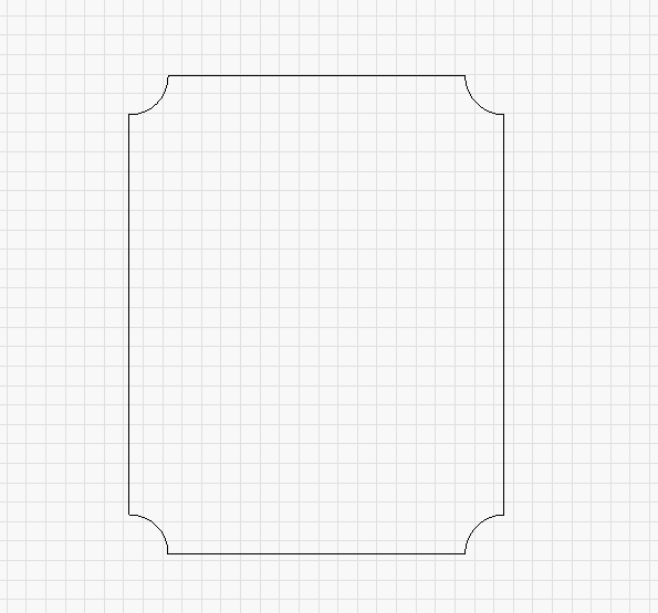

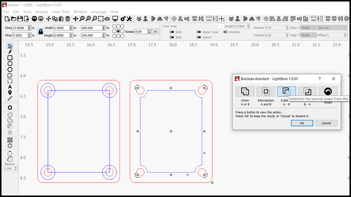

If you draw it like attached, and group the 4 blue circles, select the rectangle, then the grouped circles, and then Boolean subtract.
Gasket.lbrn (14.1 KB)
You can also radius inside rectangle
That’s even easier :slight_smile:
The inner “rectangle” looks like it is composed of four lines, so it’s not the closed shape required by the Boolean operations:
All shapes used with the Boolean tools must be closed shapes, meaning continuous loops whose starting and ending points are the same.
You must start with a rectangle and chop pieces out of it, rather arrange four sides that get glued onto other shapes.
You are correct. they were individual lines, I used the second option suggested of drawing a rectangle and then applying a negative radius. Thank you for the help.
