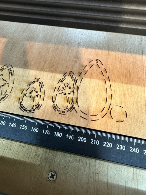

Not cutting correctly
Can anyone help with this issue I’m having with my light burn
software
I’m going to assume you want a continuous line rather than the broken line that’s apparent here. If that’s not it, please include a screenshot of your design and an explanation of what you’re after.
Look in your cut settings. If you have perforation mode or Tabs/Bridges enabled it could cause this type of behavior.
