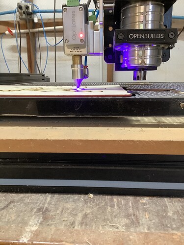

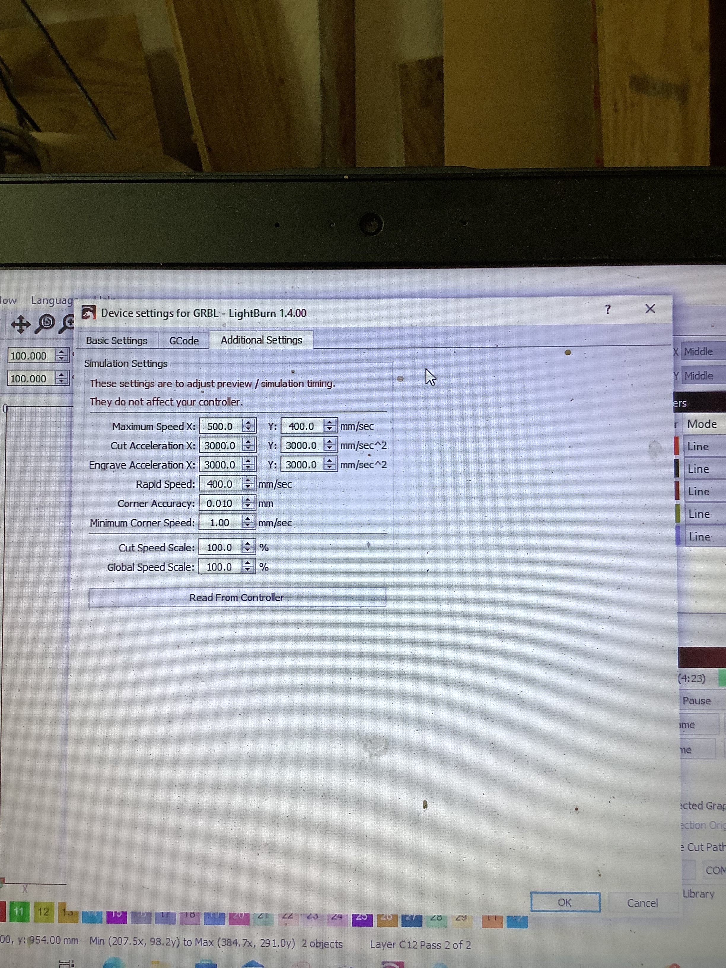

Hi, should it take 20+ passes to cut through basswood that’s 2mm thick to 1/8” birch plywood. I have air assist. I have tried different speeds, and adjusting the height of my laser from 60mm to closer. Do I have something wrong in my settings?

I think focus is not correct. 2-3mm is very thin even 5w diode laser can cut it. How much output of your laser?
Not sure where do I find that
Ok so I figured out adjusting focus and got the smallest dot I could and that doesn’t seem to help

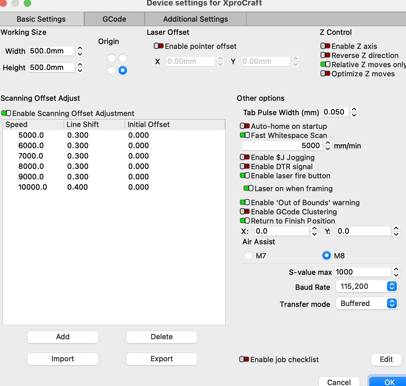

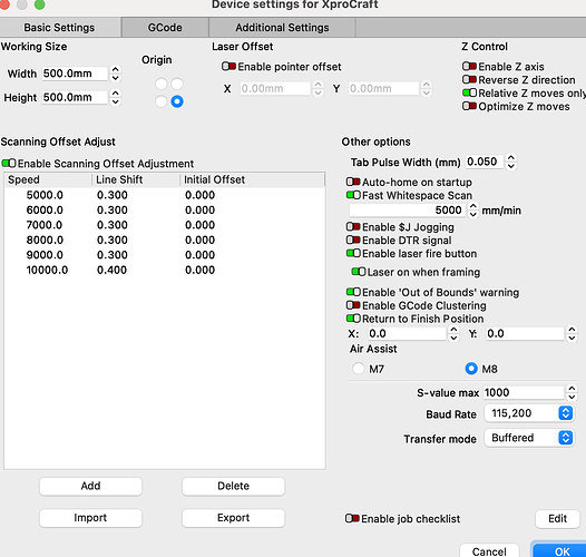

S value max is 1000?
Yeah it matches the other setting and I can’t think of which one

I would only use that head for engraving and veneer cutting, but it should do 2mm basswood with appropriate settings. Unfortunately, I have no experience with laser of that power, so can’t really help.

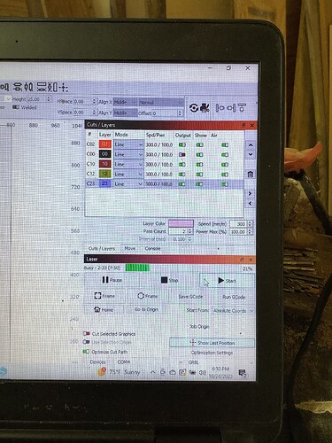

Withy 20 watt. I cut 2mm basswood ply at 550mm/min & 85% power in single pass. I’d guess I’m only putting down about w2.5 - 3x as much energy due to optical losses and a larger spot, so I’d think a 6W could the same at approx 200mm/min & 100%…but that’s just a guess.

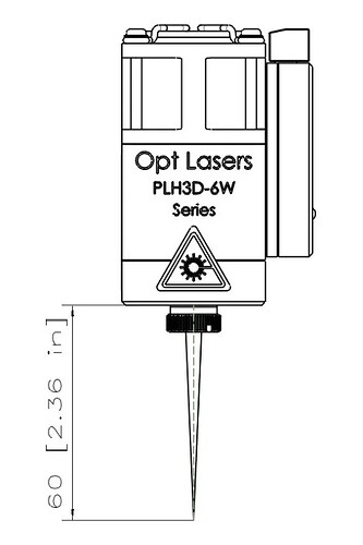

Based on the tech specs for that head, it appears your focus should be 55-65mm from aluminum diode housing to workpiece. I believe they recommend defocusing (usually that would be increasing distance) for work like you’re describing…so maybe 65-70?
I tried this forum first but will reach out to Opt.I will try the 200mm/min and increasing to 65-70mm.
