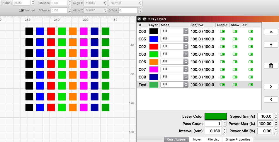

Just make one using the matrix layout tool in LB. Nobody has your machine or knows what your speed/power is.
Make a 10mm x 10mm square. Assign a colour/power/speed to that object.
Using the matrix tool, make 8 rows of 10mm squares, separated by a couple of mm.
Go to the 'shape properties panel.
Select the second object (you don’t need to select the first, it’s at 100%) and in shape properties set the power scale to 90% - do the same with the others at 80, 70, 60, 50, 40, 30%
Then select the whole column and using the matrix tool, make 8 columns
Select each column in turn and apply a color/speed/power to that column - the percentage power scales will remain set at 100/90/80, etc.
(I did a quick and dirty for illustration - you wouldn’t have the speed all the same. But the power for each column needs to be 100% to 0%, or you don’t get a proper scale).
You can check that it’s doing it by doing a preview with ‘shade according to power’ turned on
Here, heavy lifting done - you will need to decide what figures you use to best suit your material and machine:
