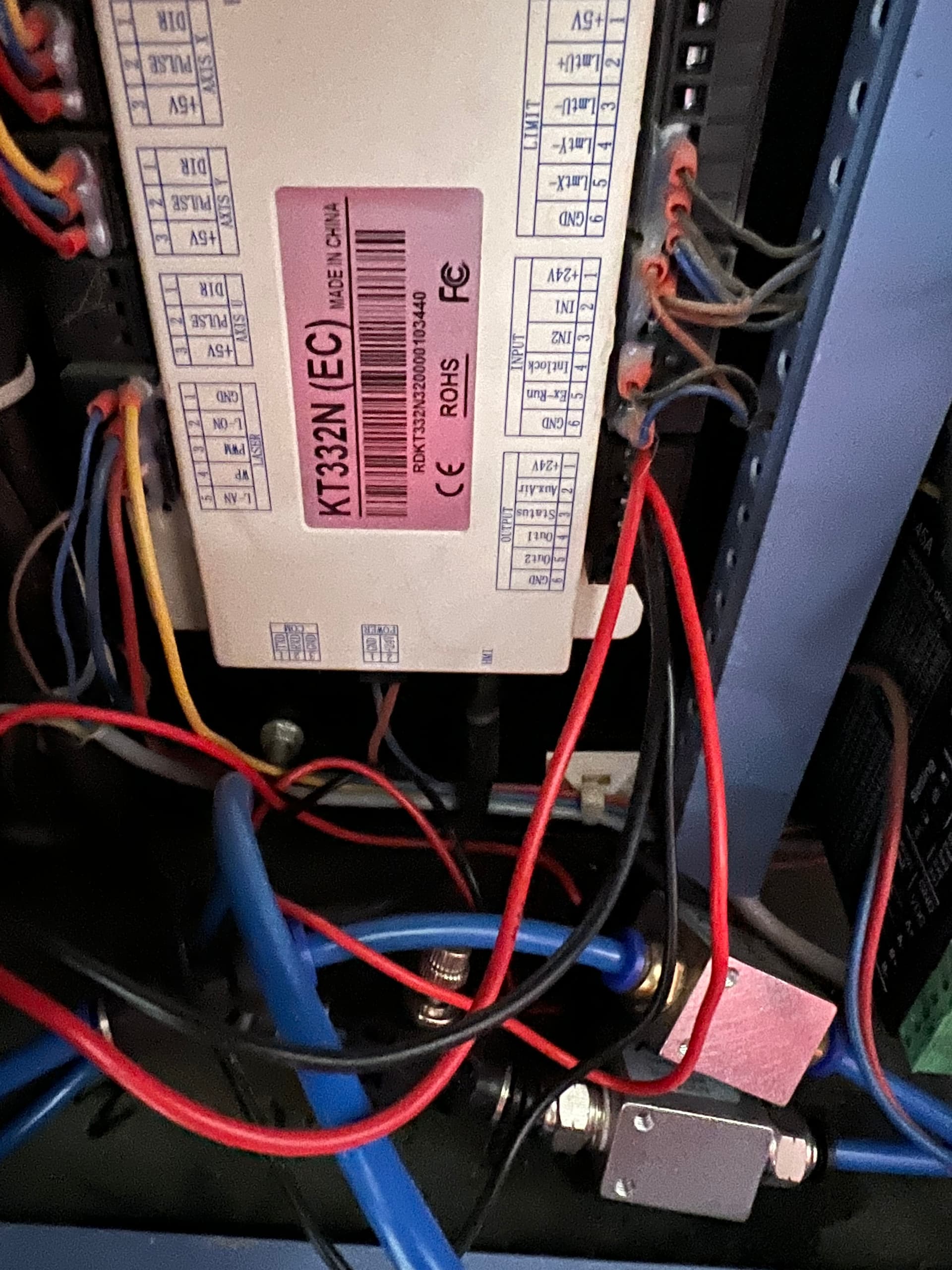

I’ve actually had the same problem with my own laser for years. What model of Ruida do you have on this machine? Please send a picture of the control panel interface as well as the unit in the side of the machine so we may identify it.
Here is my controller and board picture.
I also have a 60 w laser newer one ordered in
December but not having any problems with it.
The board inside it is a RDC6442G-B
which I have ordered one like it to try on my other laser.
Thanks
It is the same controller (KT332N) and control panel that is on my OMT 60Watt. My offer to test your problem file still stands.
Thanks for the offer.
I have 3 lasers 2 with the KT332N. I having the same problem with both lasers wit the KT332N.
I have ordered a new board to replace it.
