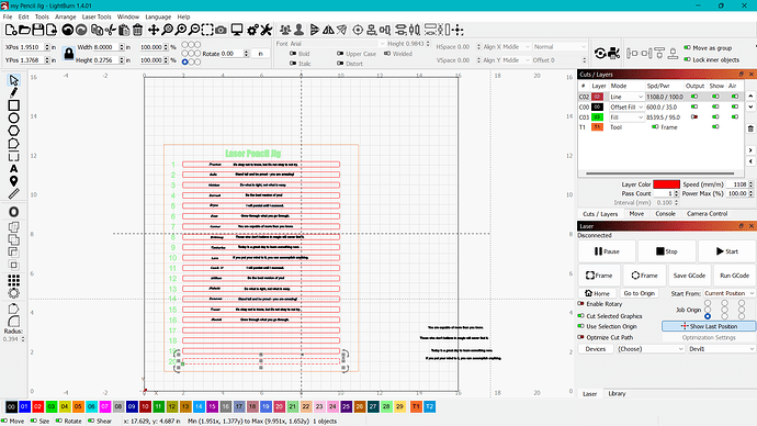

Hello, I habe the xtool d1 non pro and I run it on the Devil1. I habe had the same issue just started yesterday. After I align everything and frame it, it starts about 5mm to the right and down. I am new to all of these setting things Is there a way to fix this and can you please explain it in layman terms :grin:pretty please amd thank you.

Can you provide the following:
  1. Full screenshot of LightBurn with your design loaded and ready to frame
  2. Screenshot of Edit->Device Settings
  3. Are you using the red crosshairs or blue laser for your alignment/framing?
  4. Run these commands one line at a time in Console and return the full output:
$H
$I

I don’t see anything in the controller configuration that would be an issue.
Two things that stand out:
  1. You are using Current Position as your Start From mode in Laser window. Is this how you typically work and are you familiar with the behavior in that scenario?
  2. With the red crosshairs, you have a -16 mm offset configured to handle this. This means that the laser will move 16 mm left when burning in contrast to framing. Are you familiar with this?
If neither of these can account for the behavior you’re seeing can you make a video showing the setup and problem? Note that you will need to host the video externally and link here in that case.

I turned off the pointer offset, but I use the Devil1 kit so I also had to switch the pointer off on the hardware. And, U r a genius! It lined up perfectly with the blue laser test! So how do I fix that please?

The gcode is a little hard to interpret because of the rounded corners of the design but I think it seems okay.
Based on your pointer offset test this is what I recommend:
  1. Reenable the pointer offset
  2. Position the laser based on the crosshairs
  3. In LightBurn design either a small dot or an X shape that you will subsequently burn
  4. Set the job origin to center and burn the design where the crosshairs are pointing
  5. Measure the vertical and horizontal distance from the crosshair position to the center of the burned design
  6. Add those numbers to the pointer offset in Edit->Device Settings. So if the Y burn position is 1 mm higher than the crosshair position, add that to the pointer offset. Same for X position, simply add the value to the existing value there.
  7. Retest and readjust until these align
