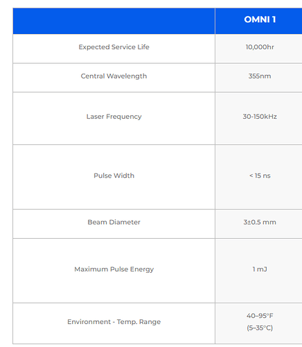

Not seeing the Q-pulse parameter in Lightburn with my ComMarker Omni 1
When I am using my ComMarker Omni 1 UV laser I don’t see a Q-pulse parameter at all. Does anyone know why I can’t see that parameter?
In the F3 screen under the laser source tab, you should see an option to enable Q pulse. I think you’ll have to close lb and relaunch in order for it to show up in your control panel window.
For what it’s worth, I’m still looking for proof that the Q Pulse is in fact adjustable for this laser source.
I dont have the machine, but from what i’ve been testing and reading on the manufacturer website this source Q-Pulse goes from 1 to 15 ns
and in test grids with same speed and freq you can clearly see the range from 1 to 15 is different
Same Speed, Same Freq and Q-Pulse from 1 to 15…
