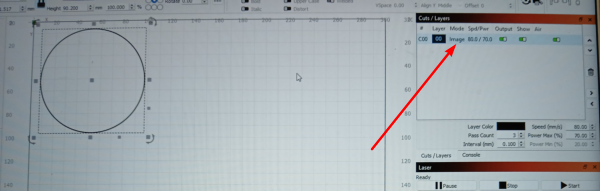

I have a transparent SVG circle that when I load into Lightburn shows “image”. instead of line, offset, etc. I’ve created it in 2 different graphic programs with no luck.

SVG vectors have no transparency, so I am guessing it is an image. SVG can be a vector, image or a combination of both. You did not say what software you are using to create the SVG, but you might try changing how it is saved.
You could also use the image Trace tool to convert it to a vector.

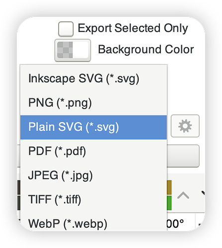

When you exported the item from Inkscape as an .SVG, did you pick either of the SVG options? Also, I always check “Export Selected Only.”

I tried all my graphics knowledge and all the suggestions I got here to no avail.
Finally tried the Trace tool and eureka it worked.
