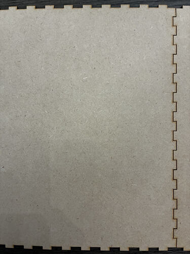

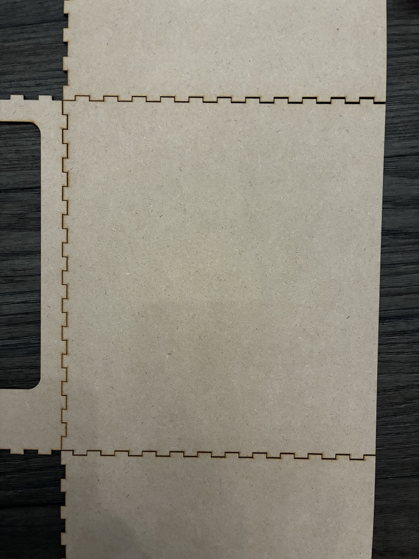

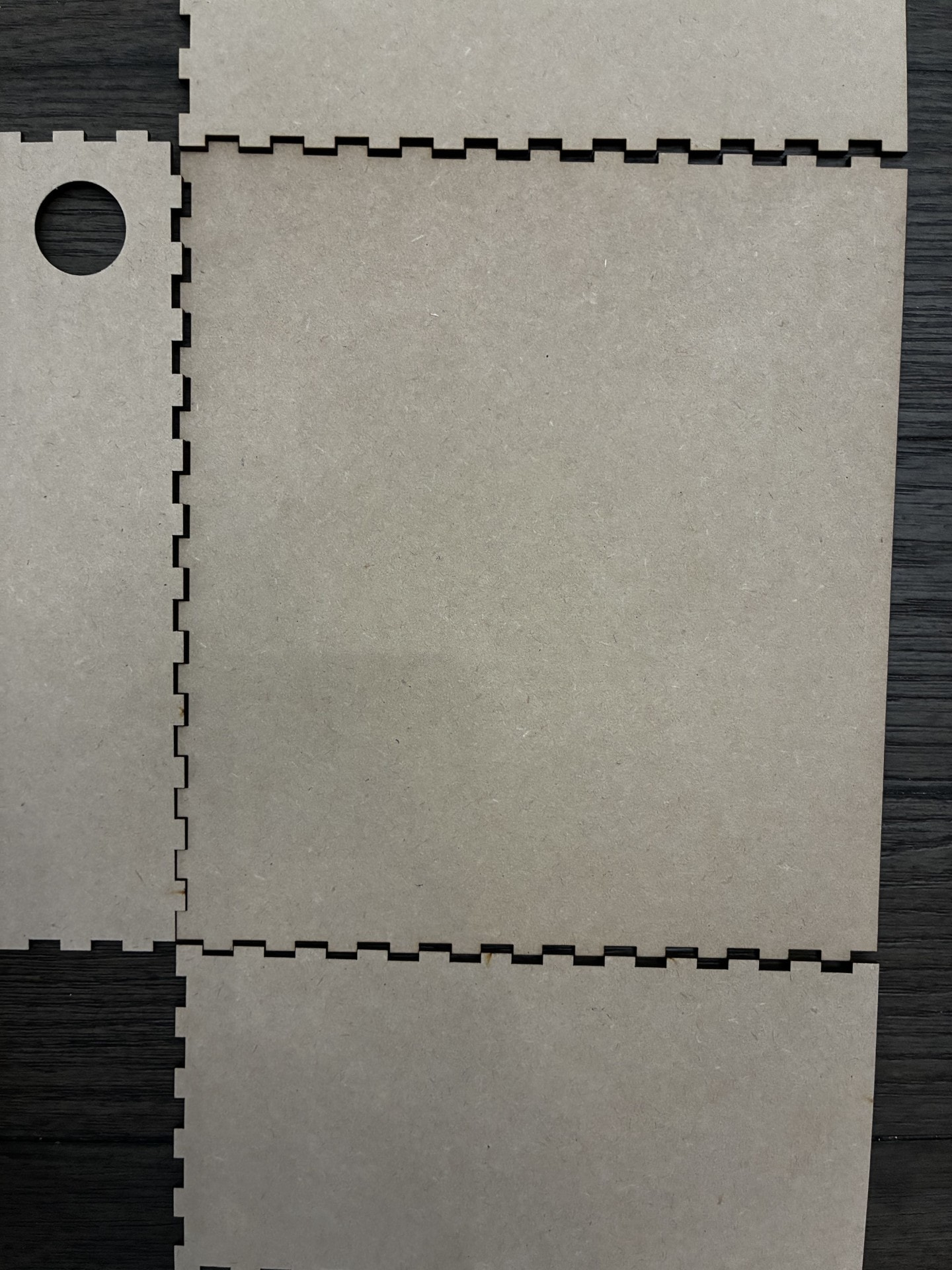

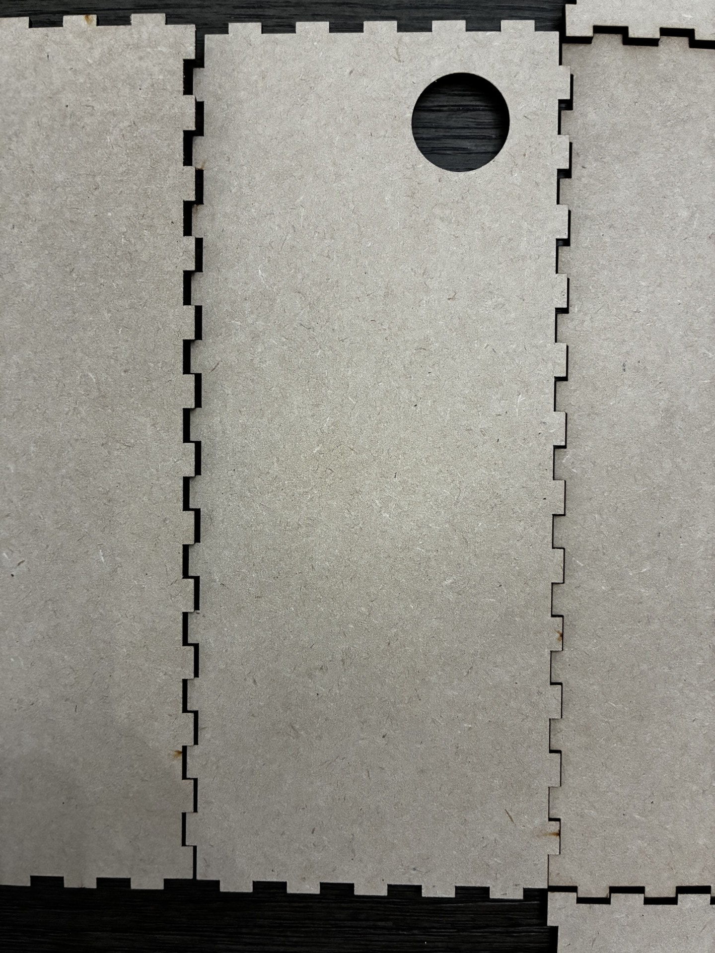

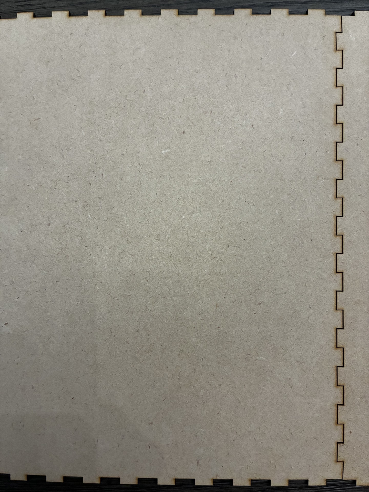

I’ve used Lightburn for several years now and have many files that include notches and tabs.
In the last 2 months or so I have had many problems with files that include notches and tabs, that have been cut perfectly in the past, now don’t fit. The notches and tabs are slightly off all around each piece. I have not tampered with the file in any way to cause this. The kerf is the same, the file is the same, the material is exactly the same.
Is there a fix for this? I have kept current with the updates and am wandering if there was an update that may have caused the problem?
If willing, show us what this means. Off by how much? Pictures or videos of both the old and new behavior / fit would be very helpful.
I hope these help.

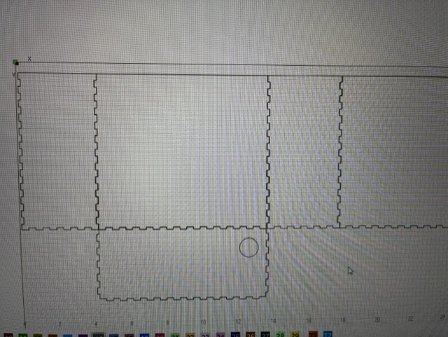

In the Lightburn program, this file lines up perfectly.
Thank you. Would like to review the file if you are willing. :slight_smile:

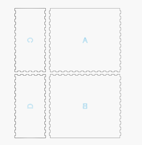

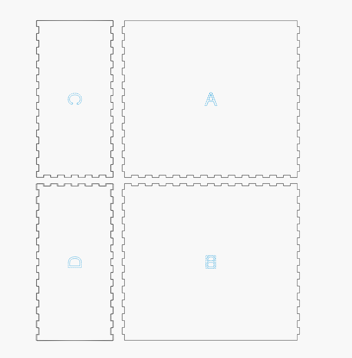

BN-002.lbrn2 (46.6 KB)
There are clear errors in your drawing/construction, mostly in parts C and D but also in A and B, here however much less visible.
An easy way to see it is to duplicate the items and mirror the duplicate and center both parts.
Ok, yes I see that now. My question now would be, why now? This is an issue with all the files I have that I have cut recently that contain notches and tabs. These exact same files previously cut perfectly. We have checked our laser cutter, the Omtech Pronto, 100 Watt CO2. Gantry, rollers all in perfect working order and no loose parts what so ever.
