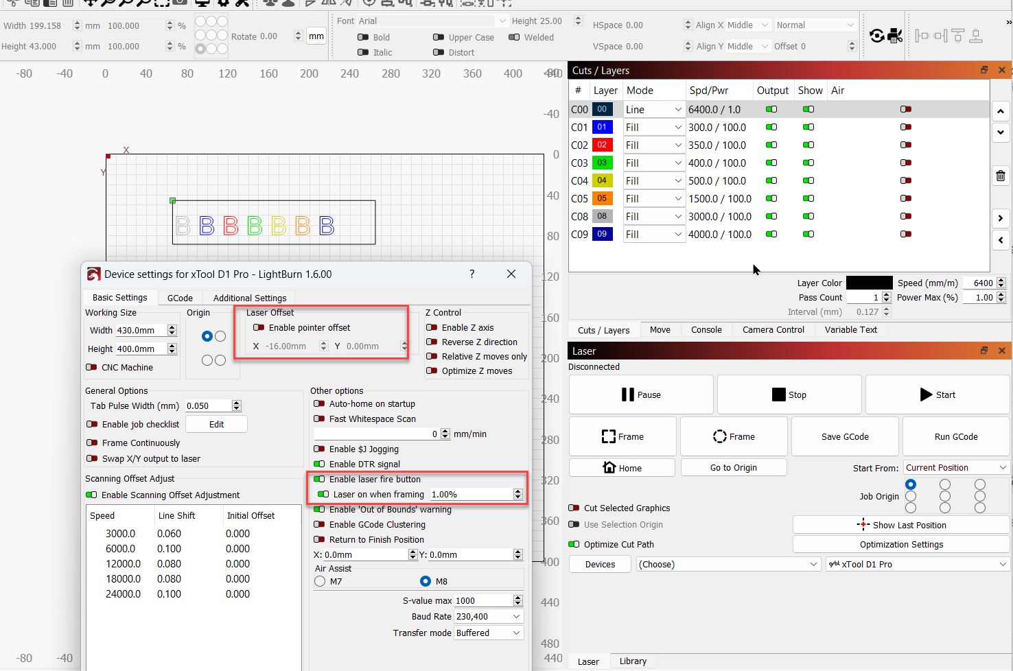

The framing may be at different coordinates from the actual job if you are using a red pointer light for framing and have enabled the pointer offset in Device Settings. This can cause problems if you are starting the job too close to the left hand edge, since the actual job will (typically for an XTool D1) try to start 16mm further to the left.
Check that your settings are similar to those in the picture below. Here, the pointer offset is disabled, and instead ‘Laser on when framing’ is enabled at 1% power so you can still see the framing;
enable laser fire button and laser on when firing buttons are not there.

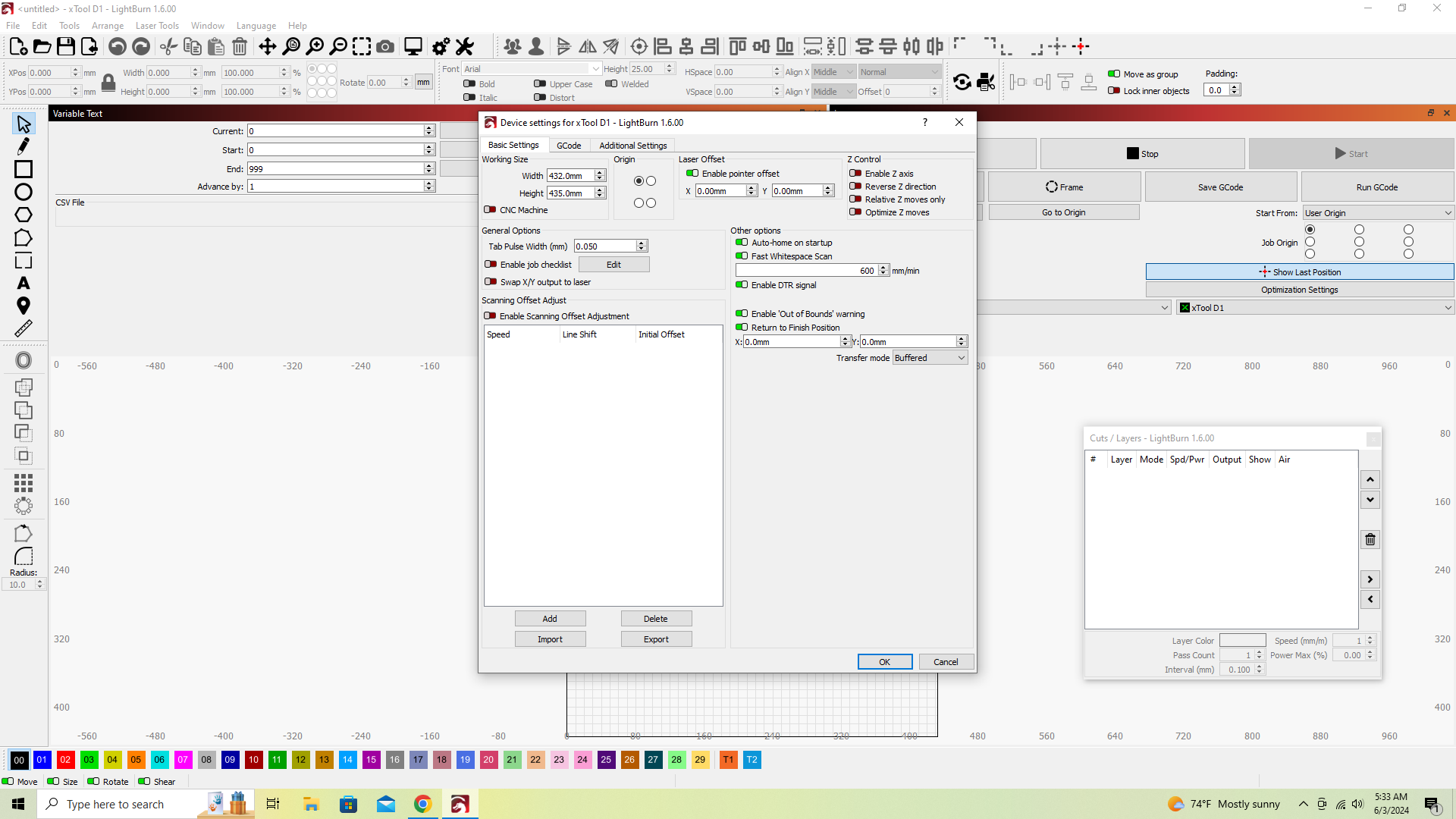

Please send a screenshot of your Edit > Device Settings.
Those settings look ok.
Do you see any error or alarm messages in the Console Window?
If so, please copy and paste them back to us.
No other errors
