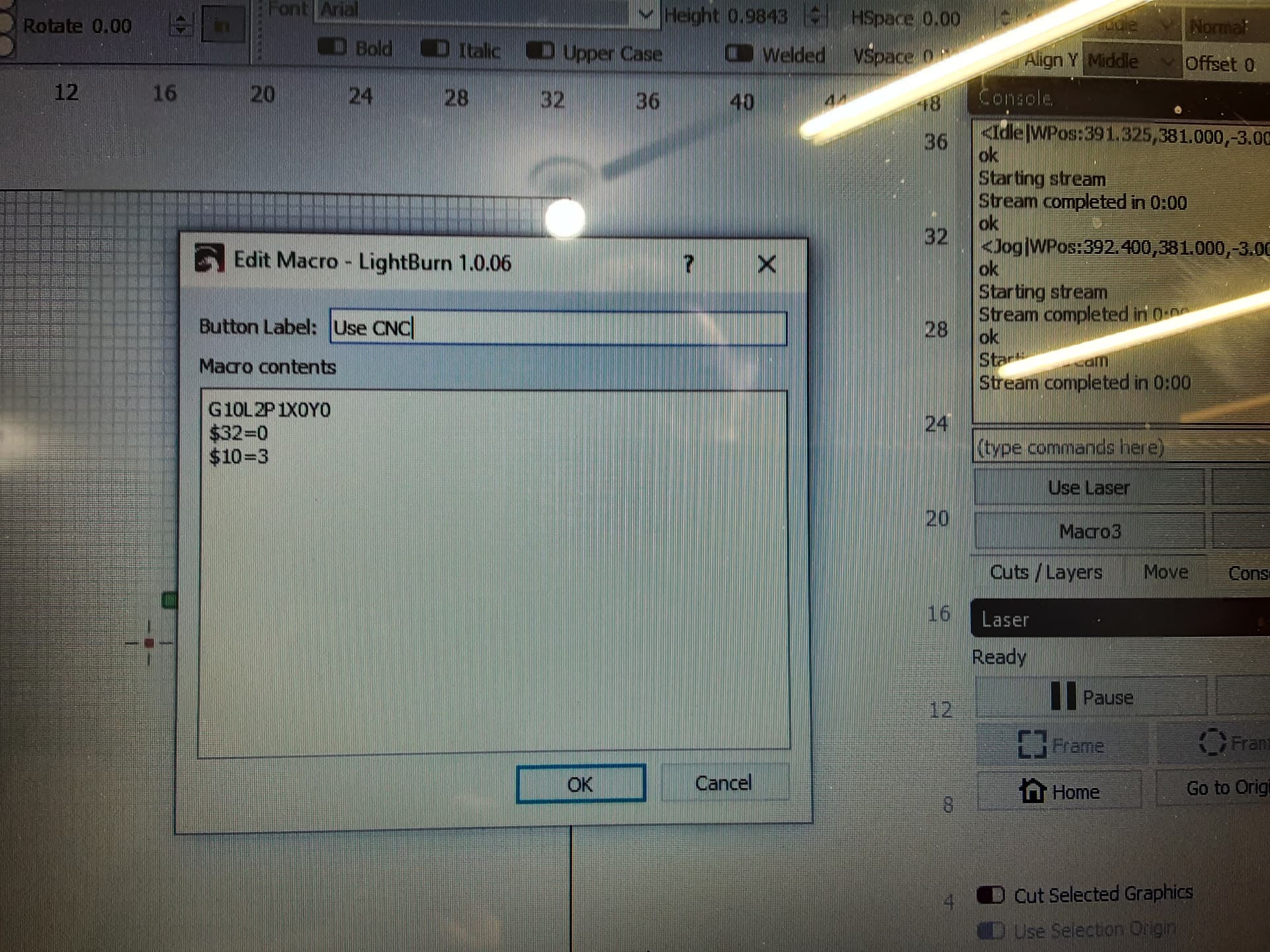

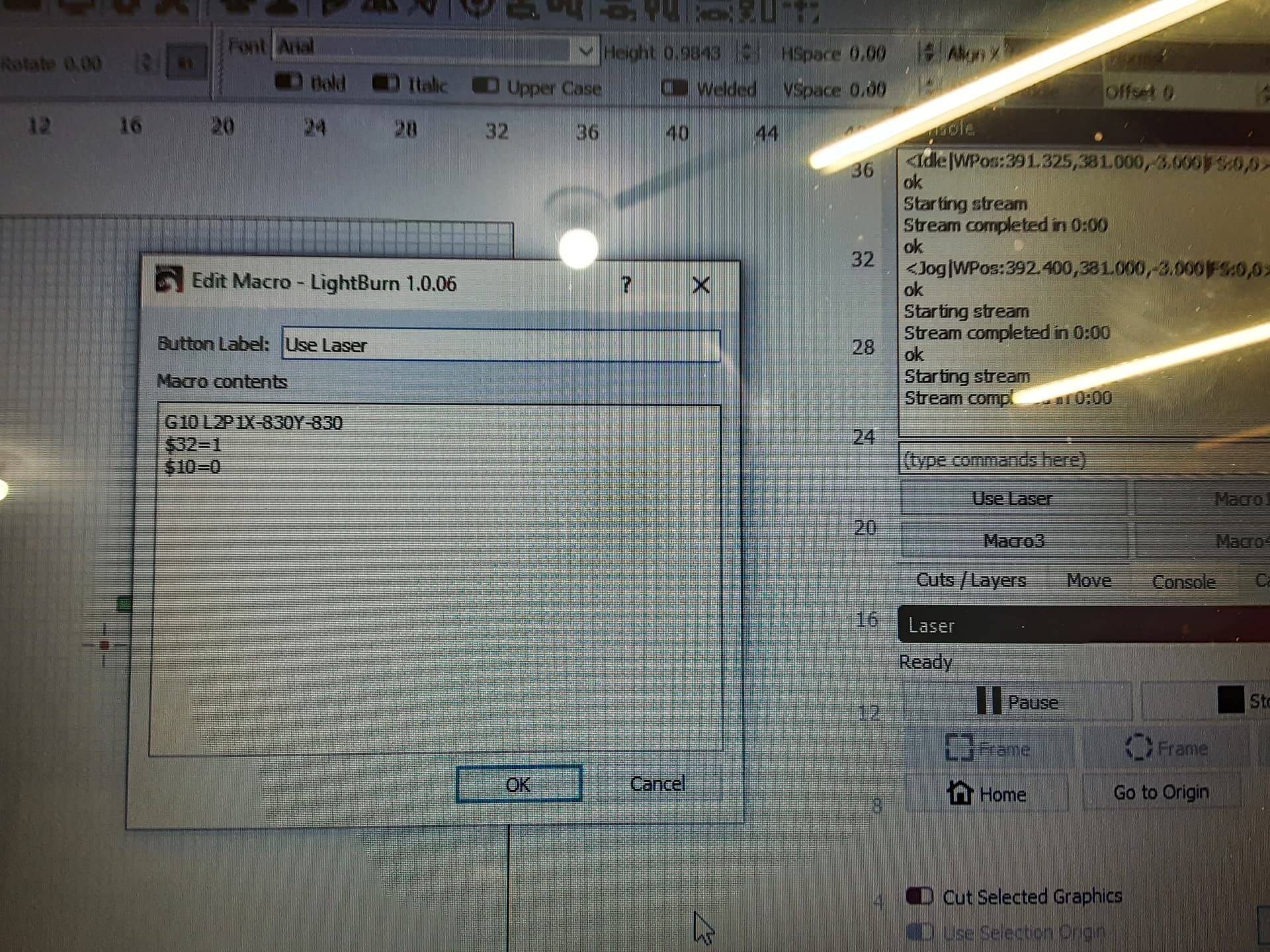

For those that are using Shapeoko 3 XXL with J-TECH laser here is what is working for me. I set up two macros as follows:
And
