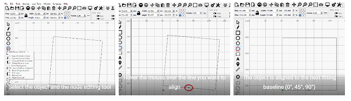

Is there a way in lightburn to select two points on an object or group and align the object or group to the x or y axis along those points? Thanks for your help.
Using the node edit tool, you can hove over a line of the object and press A to turn the object that the line is fitting the closes axis.

Perfect! I figured there must be a way but couldn’t figure it out. Thanks
