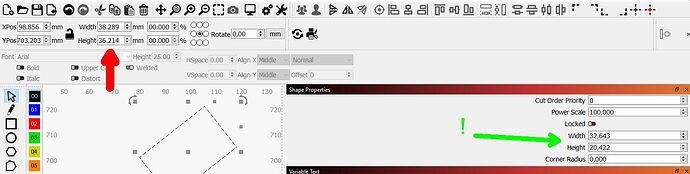

Hello when I have a rectangle 6mmx3mm positioned in a complex design like example boxes tabs holes etc.
If an object is rotated by any degrees , how do i change it’s dimensions from 6 to 5mm or whatever i want .
And another question is how i rotate objects back to 0 degrees in x or y axis?
Thank you

Just wanted to upload exact the same questions! The only solution I know is editing the object in the shape properties NOT in Numeric Section ( these are the values of the bounding box not of the object).
I have no knowledge of a graphical solution.
Rotating an object twice to a specific angle by numerical edit: I don’t know. It seems that the object does not remember its angle on the working area.
Graphically you can try to use → Arrange → Two Point Rotate.
Greetings wogl

Use the Node Edits tool, select the shape, place the mouse pointer over the line segment that you want horizontal, then push ‘A’ on the keyboard to “align” the shape …

This solves the dimension problem anyway.

So, the rotate function also works in node edit mode. When it aligns to 45 you can change it too horizontal. Learn something everyday.
