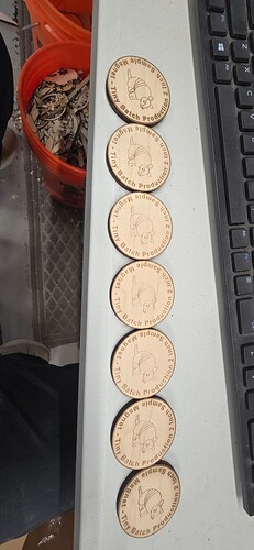

Objects at the end of a line are clearer than ones within the line

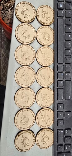

so as you can see, when doing a fill, the objects on the left and the right are clear, but the ones in the middle are light.

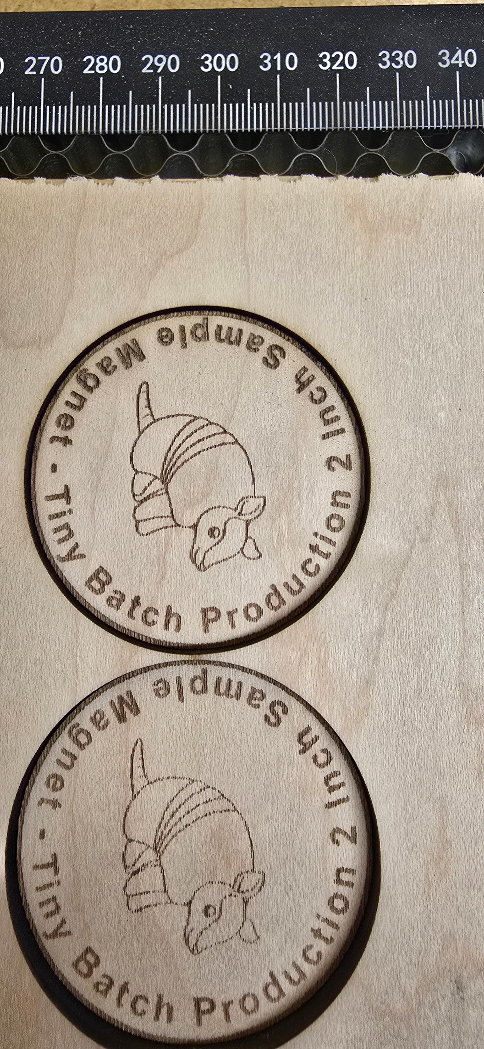

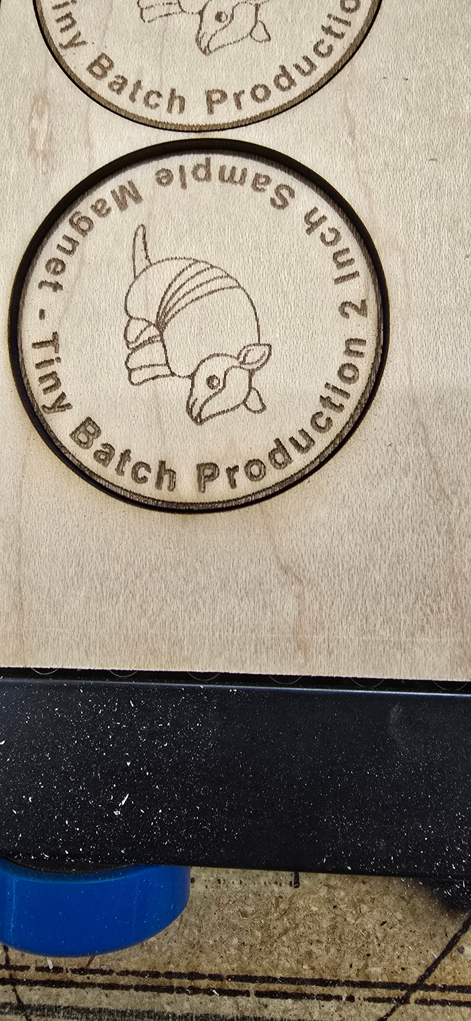

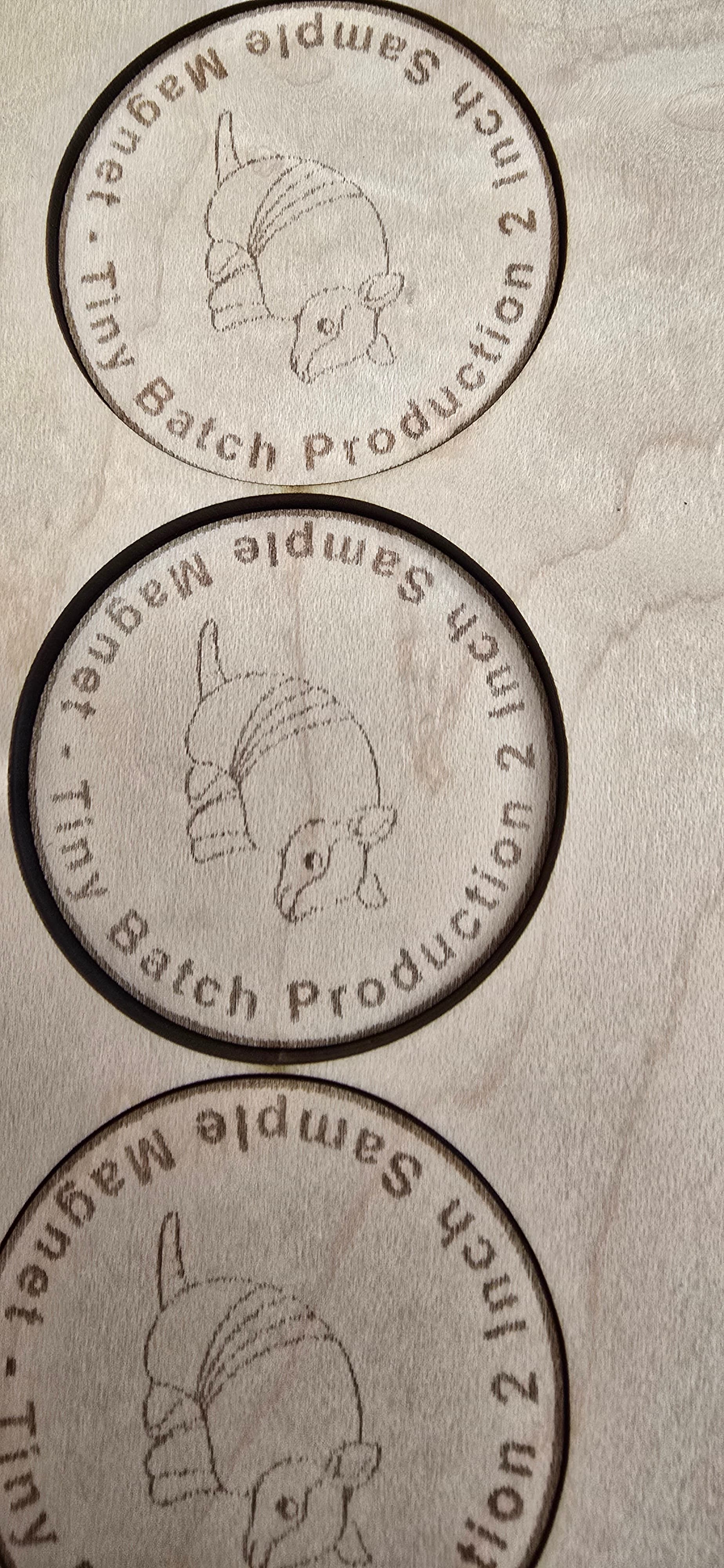

you should be able to see which is an end and which is a middle
bottom row is the last run. slowed it down a bit, the outside objects are actually engraved through the top ply of wood, the middle one just marked it.

If both ends match, then yes, it is level. But as @thelmuth suggested, there is likely a hump in the middle between the ends.
  1. Set the laser at a fixed height on one of the sides. Make sure it just barely drags when sliding the spacer in and out.
  2. Jog the laser head to the middle and see if you get the same drag with your spacer.
If you are putting your parts on a strip of wood to burn them, it might have a bow in it.

Is your material completely flat? I use clips and sometimes weights to make sure that the material is not bowed up or down in the middle / edges.
If there is a bit of difference in the height of the material across the job then you will get different engraving intensity.

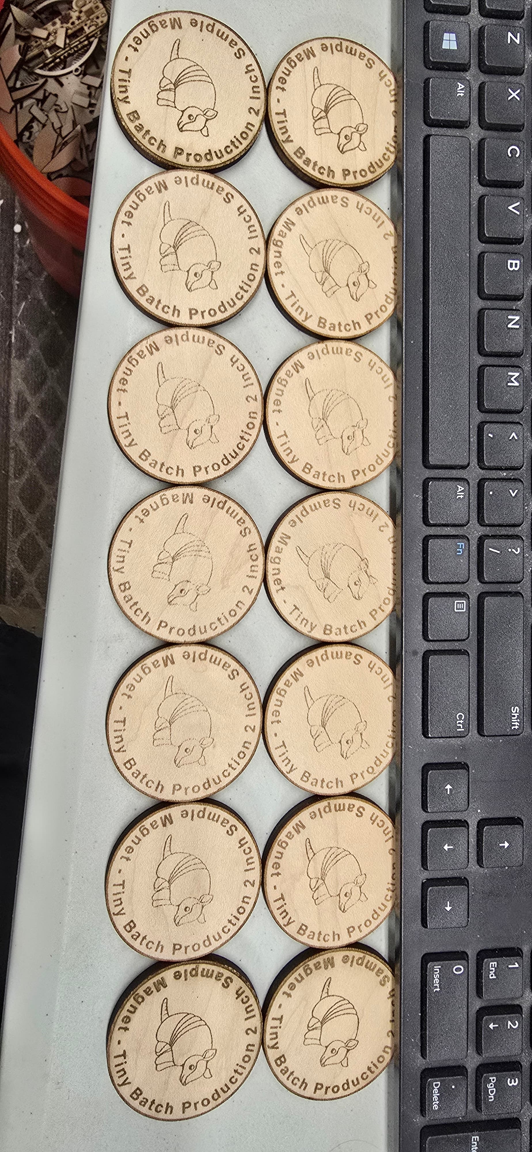

the board might have had a slight warp… i usually engrave, then cut… i tried it again by first cutting, then making sure the cutout is flat on the bed, then engrave, this helped a lot.
