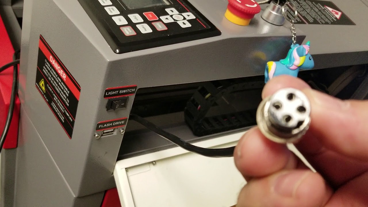

I have a Boss 2016 70 watt CO2 laser with the original roller rotary that Boss was shipping with the laser when I purchased it in 2017.
I will load the prior version and LB (1.7.03) and let you know if it behaves the same.
this video shows the rotary I have
