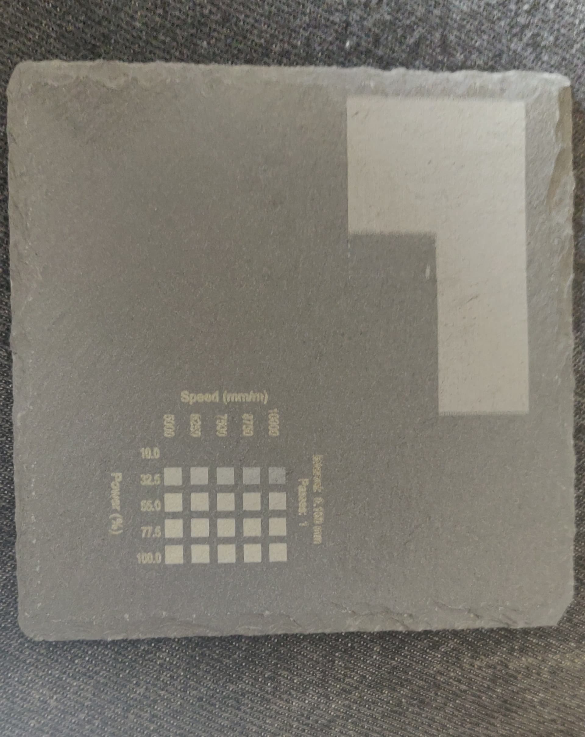

So to start off, I have a ray5 10w diode laser engraver. I almost exclusively use it to engrave slate, so engravings I’m referring to all will be on the exact same material. The laser operated perfectly fine until earlier in October. I noticed the issue when engravings using pass through began coming out terrible despite working excellent days before. Engravings began coming out with less shades on them, as in very little to no shading, and most of the image wouldn’t even engrave at all. I tested some pass through engravings at a higher power, and if they would engrave better at all, they would still have no shading, as if the laser was either on one power or not powerful enough to engrave anything, but no in between. At first, I believed my laser to be dying, but after replacing it, I continued to deal with the exact same problem.

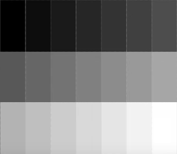

I continued to try to fix it, but then realized that no matter the image mode, my laser had this issue, so it didn’t seem to be just a pass through issue. No matter what, the laser had no interest in engraving with shading, and seemed to engrave at a lower power than I had set. The interesting part is that I could fire the laser in the move menu, and even move the laser in this mode and cut more powerful lines than the engraver would do while it was supposed to be engraving my images. This lead me to believe that my laser could be manually told to fire and do so properly, but would not do so during any job it was set to do. After I continued troubleshooting, I did the built-in material test and was surprised to see the laser was firing at different power during the test as it should. What would cause test firing and material tests to fire properly, but not a standard engraving job?

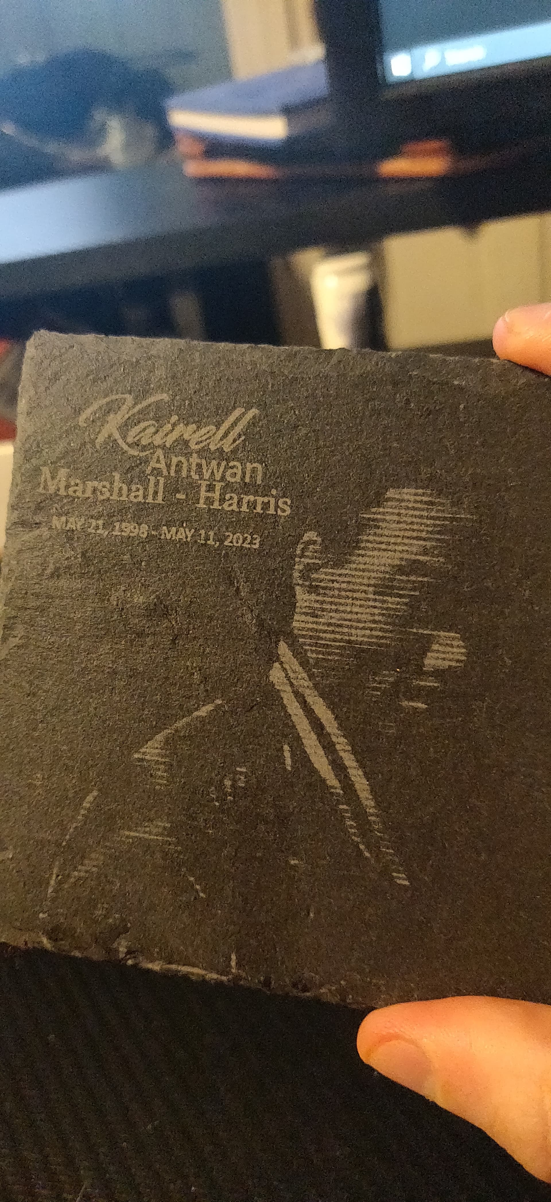

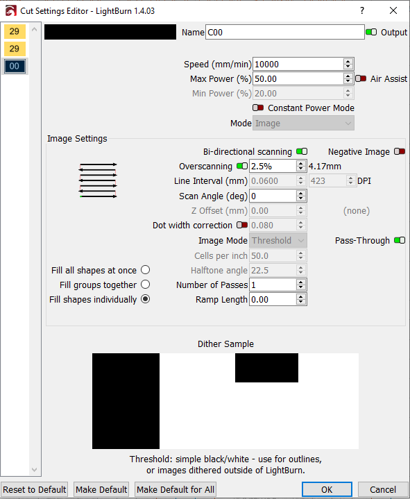

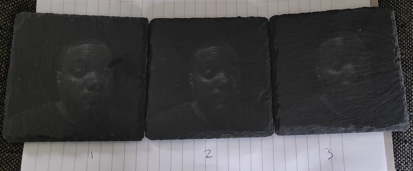

I did a quick engraving to show off exactly what happens when I do a material test engraving and when I try to engrave a non material test engraving, both using the same cutting settings that I also attached. I’ll attach what the image I tested is as well to give better context into how messed up it is engraving.
The fact that you said it is likely not the controller is a relief, as I’m broke and can’t afford to replace literally any part of the device. I clean my laser lenses, but as I said even when i swapped out the laser for a brand new one, there was no difference in the engravings.
the mechanics of the Longer Ray 5 look like it is wheel-driven, correct? No linear rails? Then your maximum speed should be around 5000mm/min. You are using 10,000 which is much too fast for such mechanics

(my personal opinion) don’t use pass-through. Load the image into LightBurn, choose one of the available algorithms and do the tests. Much more predictable.

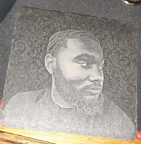

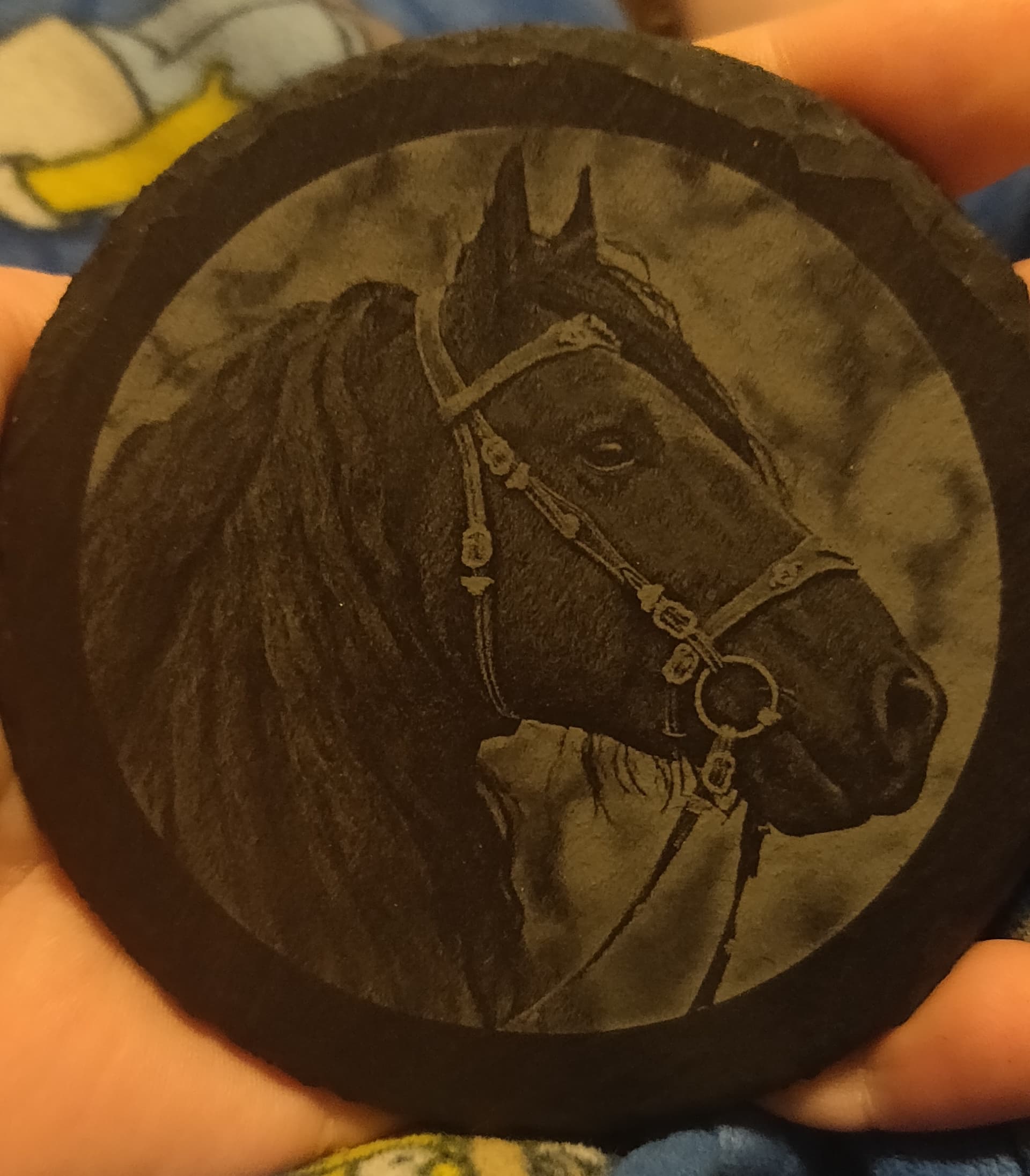

Perhaps grayscale may be an inaccurate way of explaining what I’m talking about, so I’ll send some more pictures to show what I mean. The coasters I would engravings used to manage a lot of detail, but now can’t seem to handle any at all. It seems as though the power of the laser has completely lost it’s range. I’ll also upload an image of how drastically different that grayscale image I uploaded an engraving of earlier used to be able to engrave. I’m fairly sure at least the photo engravings were all 10k, I know they were definitely faster than 5k. I had done a lot of testing to try to be optimal on how quick each engraving could be done without losing quality.
I really hope this issue is just me making a silly mistake from a settings change, because it’s honestly wild how engravings went from excellent to literally useless.
edit: added an additional image of an engraving after the engraver started acting up. I had upped the power to get it to at least engrave the image, but it just looks incredibly washed out. This is the best one I’ve been able to make since the issue arose, and it’s hardly even close in quality.

The white marks are caused by the slate being damaged by the laser. Since we see more evidence of damage on the slate now, it could be that the slate has slightly different material properties. I was going to suggest ‘clean your lens’ but you’re seeing something that behaves oppositely to a dusty lens.
When the image is washed out, reduce power and Adjust Image.
Adjust Image is an option when you right-click an image in Lightburn. You can change Brightness, Contrast, and Gamma. There’s a lot of control right there.
When you’re washed out like this, you probably want to reduce contrast and brightness slightly. The objective is to flatten the image in the Adjust Image window. If you reduce brightness, by 10% some of the richness will likely come back.

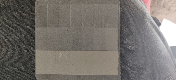

You have since done material tests with same settings as before? And you have done new tests since then. The material test I see is old one?
The power levels are very minute so anything could throw them off, focus distance lines per mm. Do you put a coating on before you engrave?

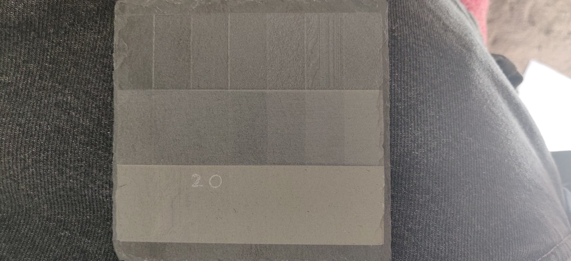

Hey I just now had a chance to see how my test engraves came out, and the 5k mm/m are looking much better than any of my tests I’d done in the past. They aren’t perfect, but that’s just an issue of just using the preset in “adjust image” not being exactly what I’d need for a serious engraving attempt.
It’s entirely possible I gaslit myself into thinking 10k mm/m was what I had it set on the entire time and in reality it wasn’t, but my roommate and I both swore it was 10k and we even have a notepad document where we kept track of what speeds to use and we had it written down as 10k. Is there any explanation as to why I would now require a lower speed to get the same result, or did I just really really misremembered my speed? I’m fine with having just made a mistake, but if there is another explanation I’d like to know since it would mean I could do my engravings faster.
Either way, I’m going to test passthrough now since I typically use imag-r for my image adjustments. At the very least, using “adjust image” works quite well!
Apologies for taking so long to get back about how the issue is now. I did a reset to one of my old preferences from before the issue, and things now work just like they used to. There was a mix between a setting being changed as well as misremembering the speed that worked best with my slate coasters. Whatever the preference change that occurred when the issue started has been reverted. I wish I had a more satisfying answer other than that, but everything works as intended now.
