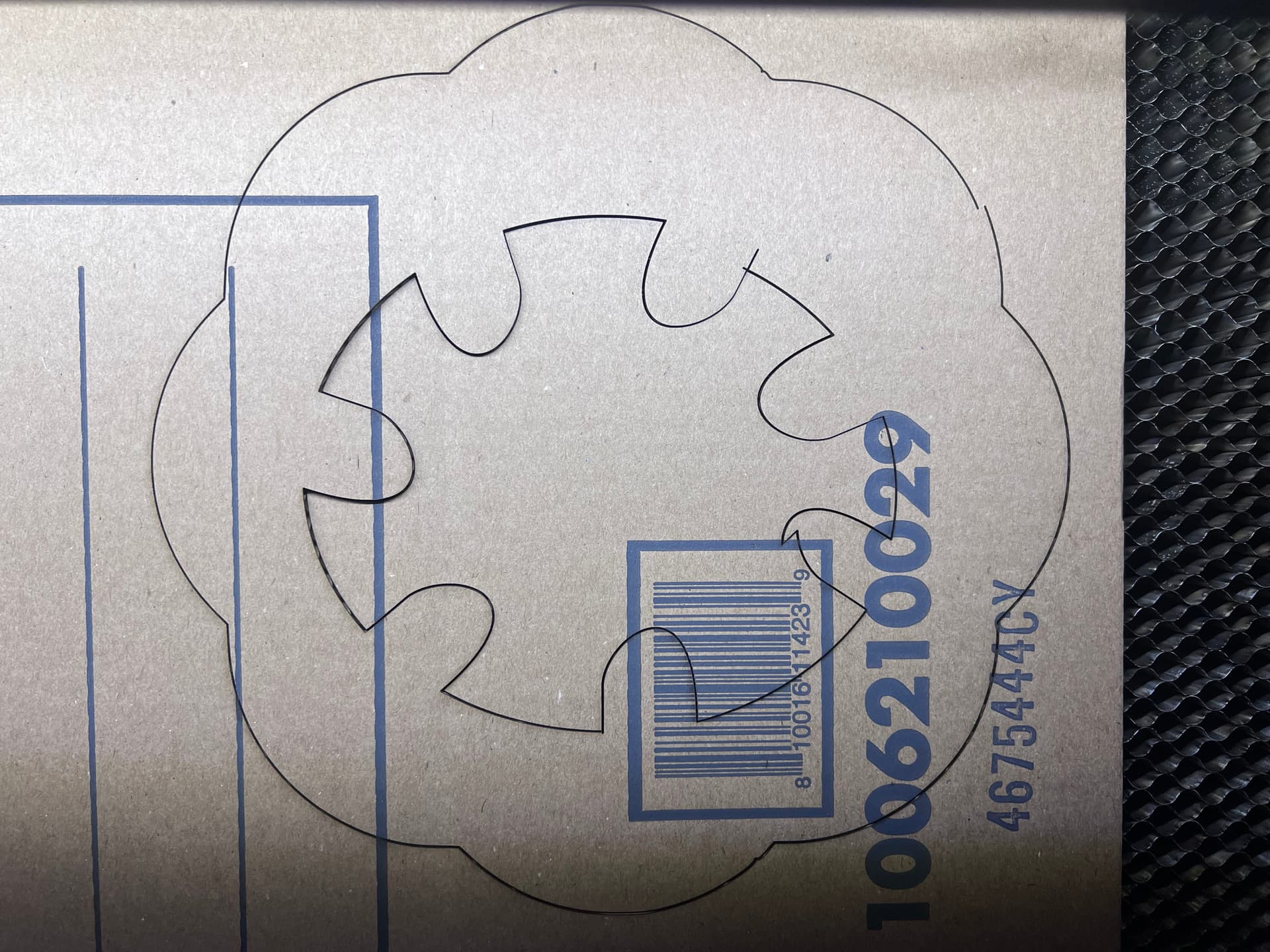

I am having some odd outputs while using Lightburn 1.7.8. (No real intention to move to LB2, unless it solves my issue(s). Using a Windows 10 laptop. BossLaser LS2440 70w CO2
I’m starting to see odd outputs after running the laser for a few projects. Each project has 1-2 issues, with the latest one being at least 3. I’d love to see if the issue is with LB or the laser itself.

Issues:
  1. This issue here is not on the final product. It was there at one point and I fixed it, then I ran the program to my machine.
  2. No idea where LB got this shape, this is clearly not in the final product or any version of the product.
  3. This looks like a small miss step as it clearly did not connect back on the other side. Not a big deal, this is still a rough draft.
Anyone have any ideas why these issues come up? Should I check more things on my laser? Is it possible a file corruption occurs when sending to the laser and the code gets messed up?

Be nice if you put this in your profile, along with the type of controller it’s using.
This looks like it’s on the laser bed?
This can happen with any communication system. If you’re running usb, I’d suggest you use Ethernet through your lan, much more dependable. It also has nothing to do with drivers, if you can access the Internet, then you can access your laser.
Is this what it looks like on the lasers console?
Looks OK in Lightburn, I think. :face_with_spiral_eyes:
Are you using minimum power?

I am connected over USB, correct. If I try Ethernet I’d have to run a temp wire across the garage to an Ethernet/wifi switch. Laptop I don’t think has an Ethernet port, it’s not that old.
I did another run of the same file again and this time I got that weird little claw/eagle thing on a different object, which I’d doubly weird, but makes me lean towards a difference in the file when it connects to the controller.

Have you tried to save the RD file, then copy it to a USB stick and see if that shows correctly in the machine console… it does show up correctly doesn’t it?
If all else fails, maybe Ethernet.. Don’t do a direct connection to your pc unless you know how to configure your Ethernet port for the Ruida.
Hello, check ALL your layers, there seem to be double lines. When you use scissors, zoom in as much as possible! Also check your work if you used the “close path” function. The problem seems to come from there, nothing to do with the USB or anything else. Under Ruida, sometimes the memory saturates and causes bugs.

It appears to be file corruption while connected to the controller/laser via USB.
I ran the same files using RDWorks, which is the open source software for my Ruida controller. Same issue(s) came back again.
Next time I connected the laser to my network via ethernet and ran larger files of the same living hinge and had 0 issues. It was 100% correct.
