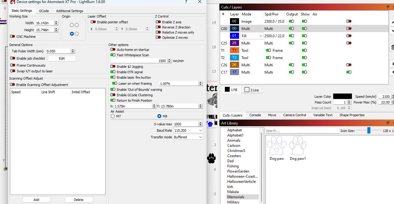

Hi David.
Please share a few screenshots, specially froM EDIT > Device settings
And a screenshot of your latest design you noticed that happening showing the laser and layers panel.

Thanks for the input, i use win 11 and will try another browser. Not bad idea. I report back with my findingd.

Maybe open task manager and check the performance tab, it system load goes up once you switch to the browser.
Will try that thanks, try different browser with same result also. This is definitely odd that it affecting thr serial port like that. Thing is i try it on a laptop and desktop with same results. Driving me nuts trying to figure it out.
Also check if Anti-Virus and/or system updates kicks in.
Also try with browsers open but Network disabled.
