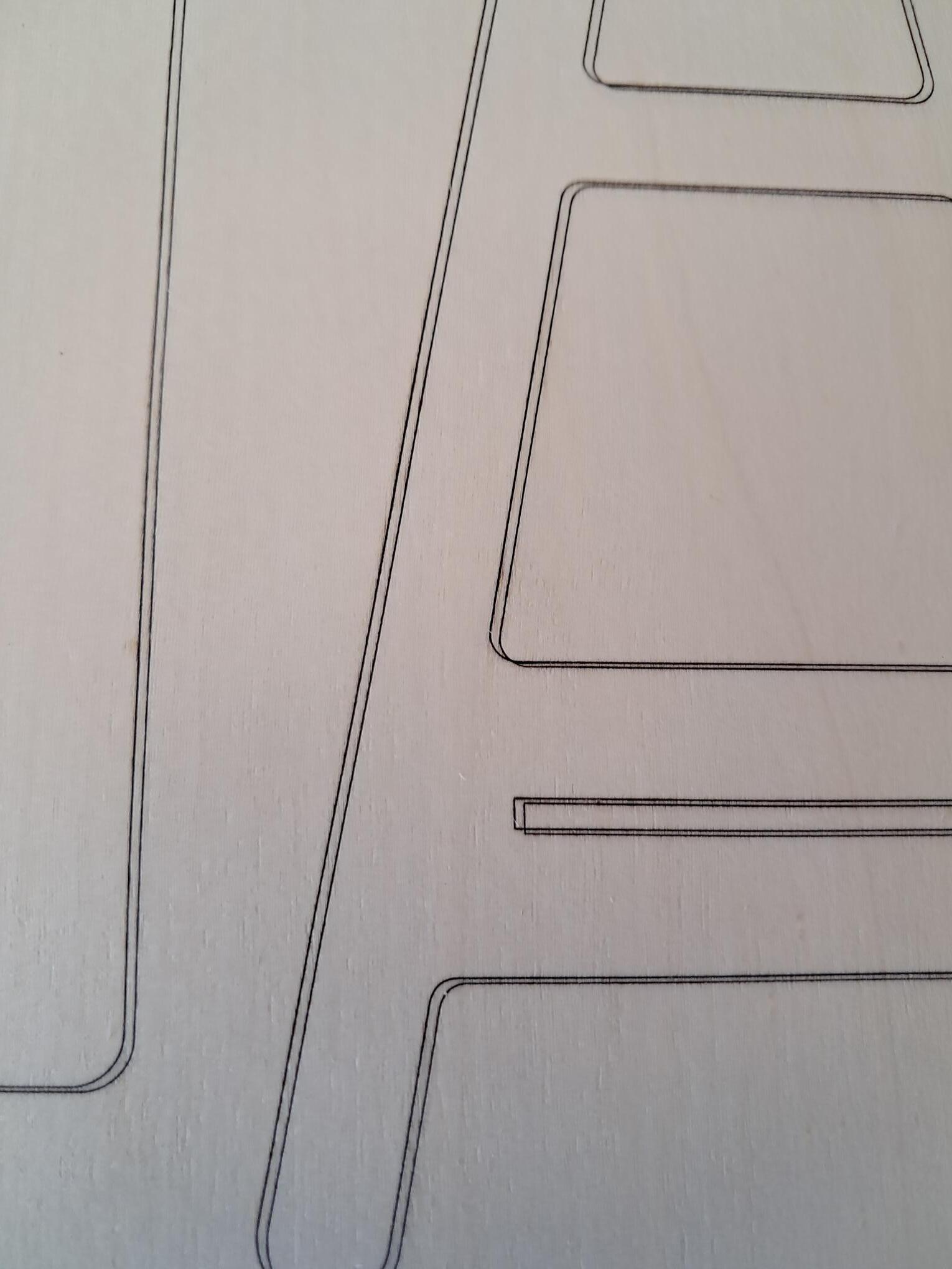

hi all I am running a Sculpfun S30. Lightburn 1.7.08 purchased a file from Etsy of a small easel to use as price list on craft table.
I have had no issues with any other files.
Ran on 300 at 100% the second pass has run off set from the first cut line. ran a third pass it ran off even more.
advice to stop this please.
martyn
Your photo shows a mechanical issue. Your media is shifting, or your laser is losing its position due to belt tension or loose bolts or set screws - or unstable work table
