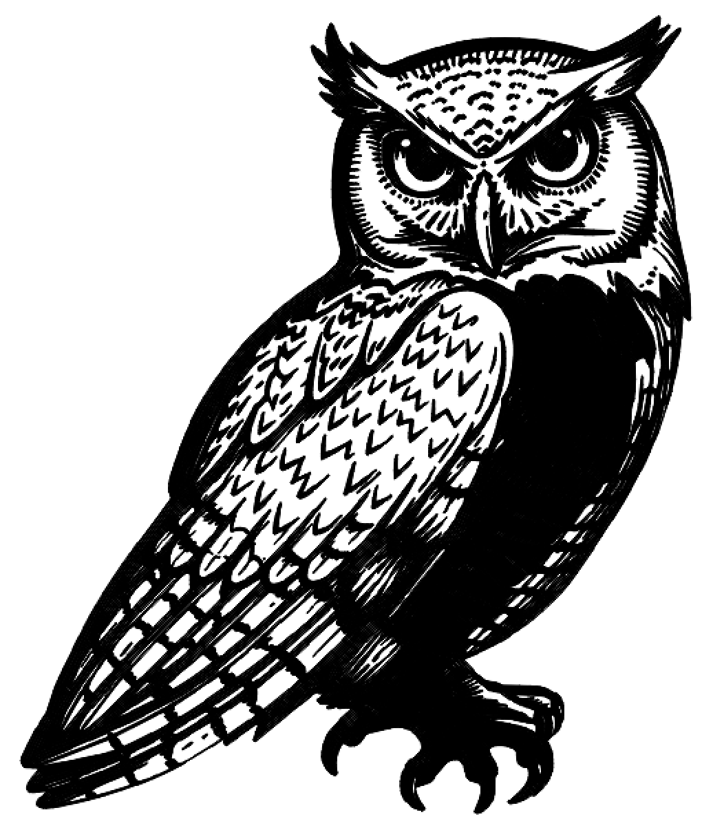

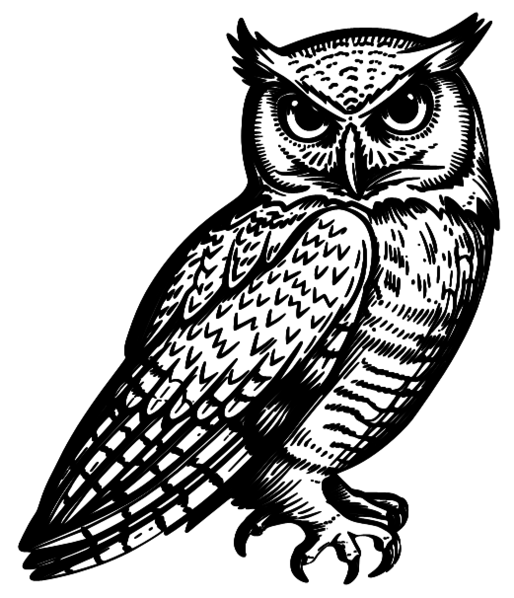

New Lightburn user here. I have a vector file that I’d like to burn using offset fill, but the preview shows that some areas with scattered black segments are coming out solid black. If I use regular fill, the areas appear as expected. What settings might help get the correct output with offset fill?
Editor:
Offset fill preview:
Regular fill preview:
