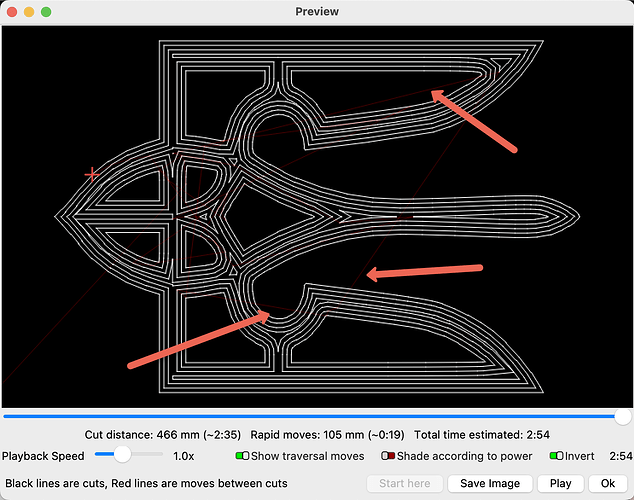

Is it possible for “Offset Fill” mode do not travel between parts of shapes when it was not already engraved there, so it brakes the drill all the time :frowning:
For example I need to engrave “C” character, but it starts from top makes 1 line and then trying to move to another part of “C” but there is still material and drill is broken
Thanks!

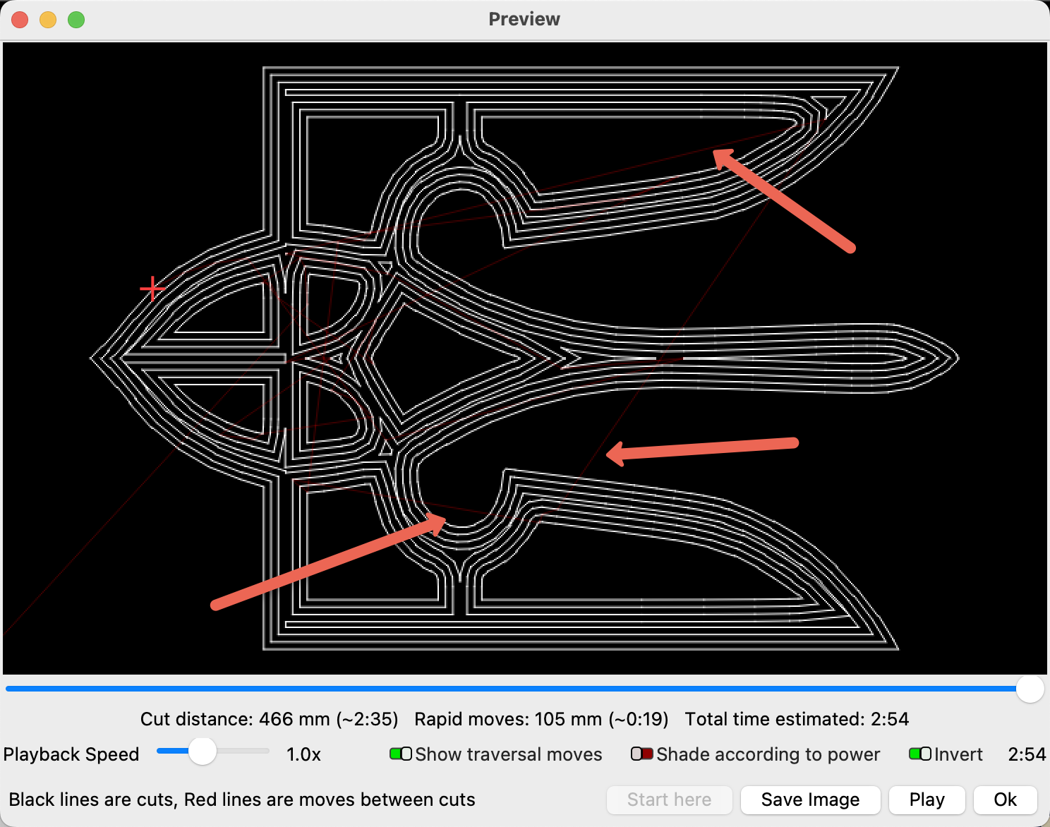

So I don’t want to travel on the places where is not engraving at all. As you can see on the image it travles just trough “C” where is any engraving
On this image it is clear that traveling happening not inside the shape.
Any solution, any way to make it not traveling around but only in the shape boundaries?
I think, those requirements are mostly relevant for CNCs, but not that much for lasers. Rather than making LB work for your use case, I’d check out MillMage, which is the CNC software from LB. It is not released officially, but you might reach out to the team if a test is possible.
