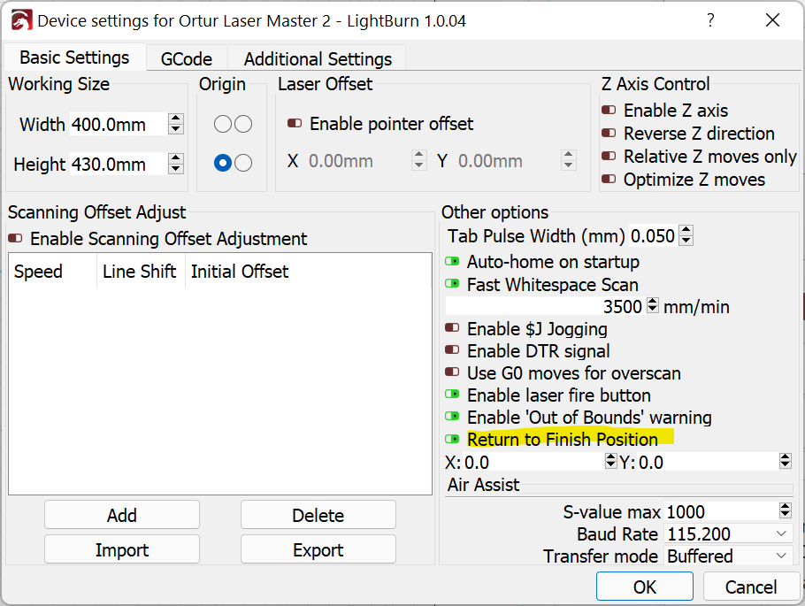

So I am having a small offset issue on the 2nd or 3rd pass from any origin point (absolute, user or current). So if I engrave and cut, and when it completes returns to home or current position, if I hit play again, it is about .2 mm offset from the previous cut.
I don’t think its the controller or the belt as in LaserGrbl I can do multiple passes without any issue.
Again its not multiple passes in one run that has the issue - its when I try to do another pass after it has already completed.
Is there anything I can check? Thanks in advance for any help.

If it works in LaserGRBL I don’t see any reason it couldn’t work in LightBurn. Suggest you review your device settings and see if you’ve got something weird going on.
Specifically, check Return to Finish Position to see if it’s checked and that it’s set to 0,0:
Also check the GCode tab to see if somehow something else got in there that shouldn’t have.
Thanks - I checked the setting and it is set to 0.0 and 0.0.
