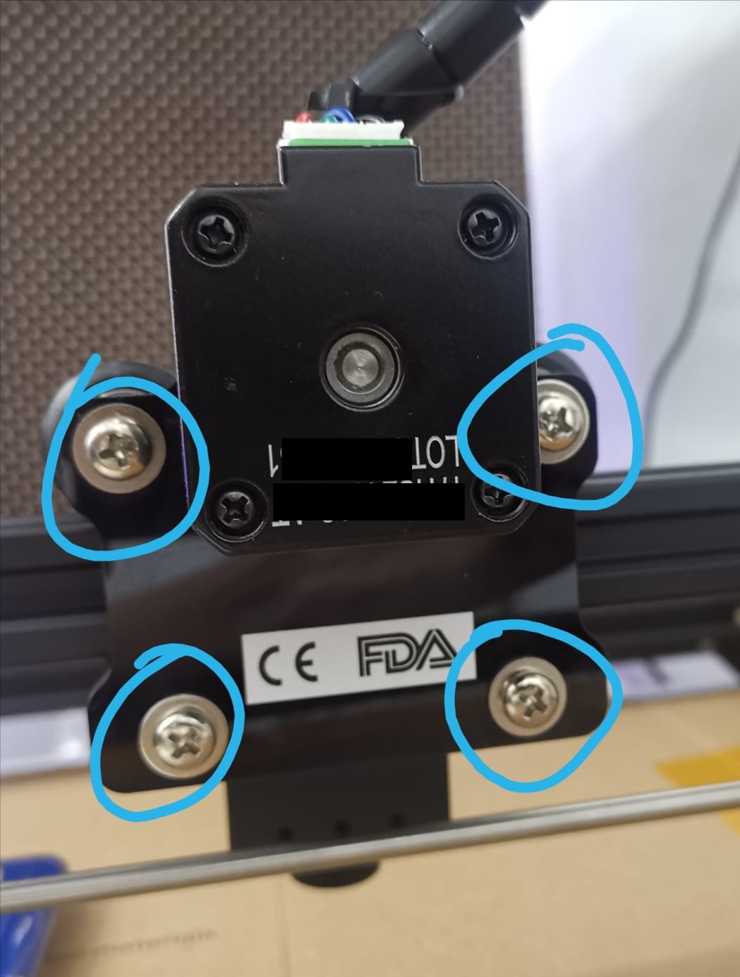

Managed to solve this problem after searching the net.
Will provide my solution, in case other people have the same problem as me.
So what I did was unscrew the 4 screws at the back of the laser and make them not so tight. If you tilt the whole frame 45 degrees on the side, the laser should move by gravity, this is normal. Mine didn’t move before, as my screws were too tight.
I tested it out and now the laser is aligned.
The 4 screws circled in blue
