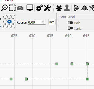

and after the import, the green dots appeared:

Within Lightburn, right click on the line and choose convert to path. This save the step of exporting/importing.

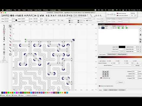

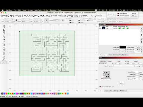

It is you who have asked me for help in a PM, I would rather see that technical problems are solved in the public LB Forum, so it suits me just fine and everyone can benefit from a possible solution of the problem.
I have only used your files and did not change them.
Only used tools are found in the last official version of Lightburn.
Here are the 2 videos you’ve asked for
The missing Contex from PM you need to add, otherwise it doesn’t make sense to others.
