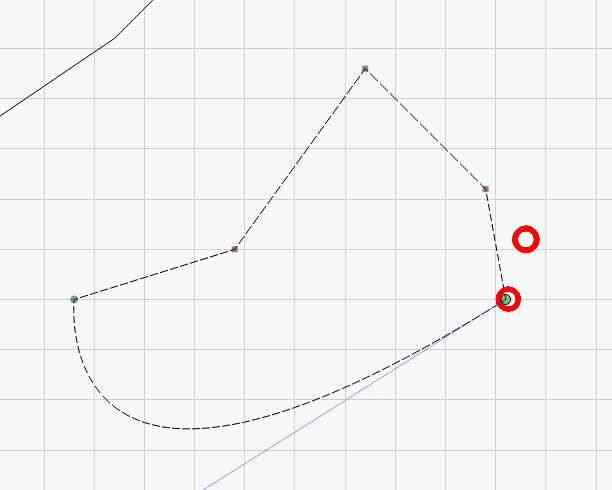

problem when try to connect two last points on drawing shape on picture two. when points connect lines go far away.

I want close this shape with red line but you see black line,black line go far away on right. sometime that be few meters.
How are you closing the shape?
This is because LightBurn attempts to preserve the initial curve from the start point. Try also ending with a curve.
Or else, just convert the final line segment into a line rather than a curve.
Thanks, it works well when done that way.
