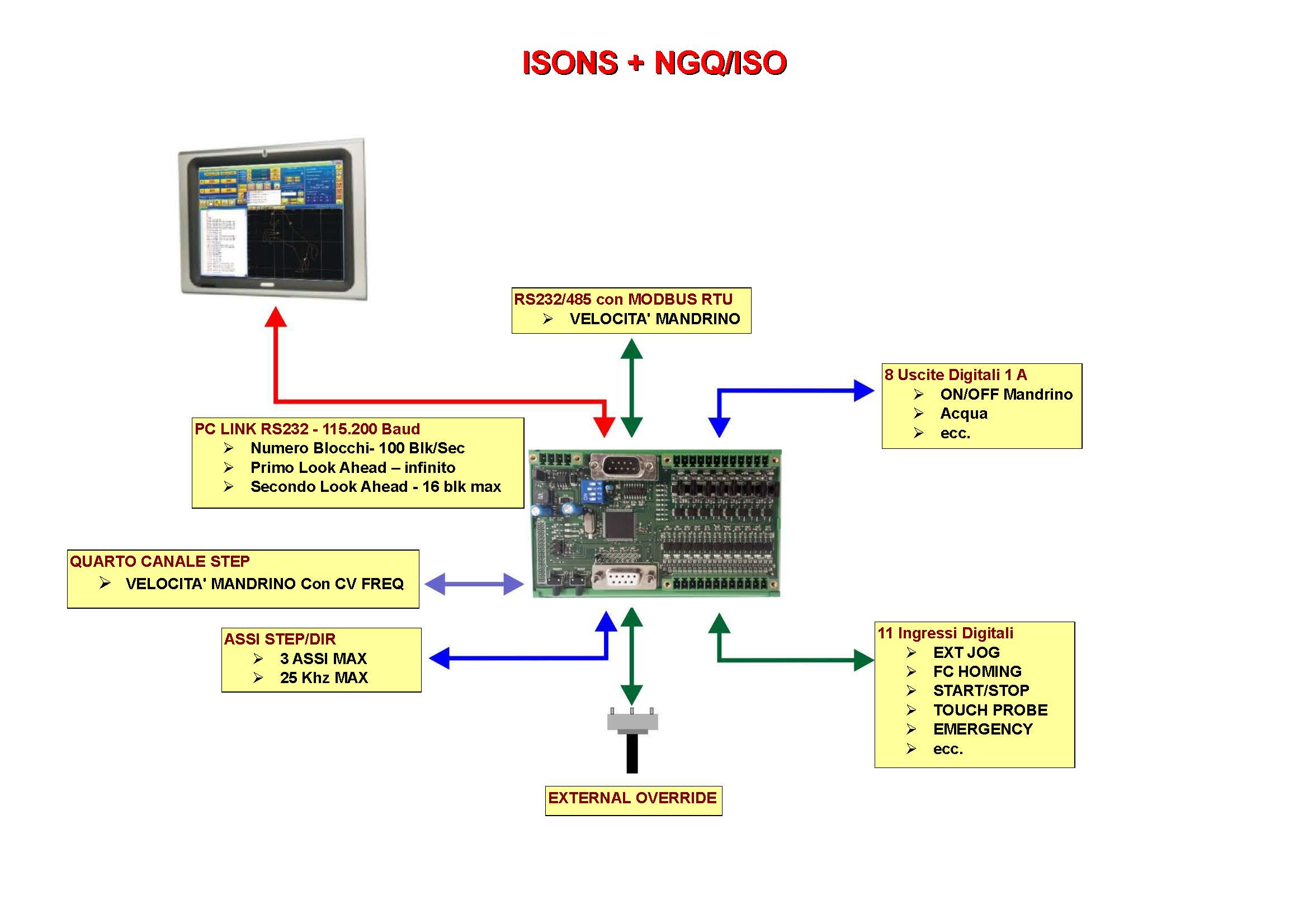

Good morning everyone, I have a CNC from LARI &LARI and I use the Aspire program to create the Gcode and a proprietary program of the machine, called ISO NQ…
I would like to know if with MillMage I can directly control the CNC or use it only to create the Gcode.
I connect the PC with a USB adapter for the serial port
Hi Federico - I’m currently not aware of ISO NQ as a software, so my bet would be no, MillMage cannot directly control it. I can’t find any information on ISO NQ online, so I cannot confirm.
MillMage can probably produce GCode that is compatible with your machine, however, just not control it directly.
I attach a picture of my CNC board… maybe it can be useful…
MillMage will not control this controller directly.

If Lightburn won’t control your CNC, MillMage will not either.
I use lightburn with my laser not for the cnc…
I know, but I can use Lightburn on my CNC when I swap the spindle motor for the laser module. In other words you could always try, but with your industrial controller I doubt it would work.
