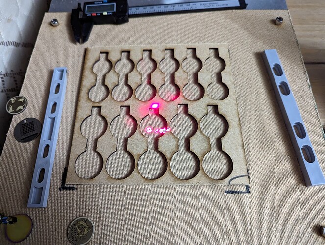

I thought making a Jig for dog tags on my fiber would be easy… and I was quite proud of myself cutting the base board and shapes into the 2nd piece of wood. But am I right in thinking each shape will have to lined up separately? I thought if I lined up the bottom right and top left the rest would align. No such luck and my head hurts lol. I really want each engraving to be totally precise if needed. Yes most designs I can get away with things being less precise but if I want to do a round edge around a 25mm dog tag it needs to be absolutely precise or it will look messy. …

I set the boundary to the exact size of my galvo lens bed
175mm and within that created shapes using the array and centered the shapes within the boundary.
So after cutting shapes I had the shapes and boundary still on my computer…I switch to to galvo on lightburn centre the same shapes and box within the new work area.
I then go to preview and the shapes and box are flashing on my bed area I try to use this to line up the board I have cut and assume it must be easy but the shapes on board do not line up perfectly.
I thought for example if line up the bottom right and top left shapes that naturally the others would like up.
Am.i getting mixed up? I am using lightburn for both my CO2 and galvo.
So to clarify I am wanting to make a jig for galvo and I have lightburn for both CO2 and galvo and I cut my shapes board using my CO2 and then placed it on my galvo bed to line up the same shapes now using lightburn for galvo
You don’t have to set the boundary to the same size as the bed, but you certainly can if that makes it easier.
If you’re in preview and you redline one shape and get everything centered up, but the reset are all out of alignment, you have something wrong with the tuning on your galvo. As long as you’re moving everything as one whole shape, including the boundary, the shapes are where they are, and should all line up.
Okay thanks for that but what could be wrong? Maybe red dot alignment? Perhaps the C02 is not cutting the shapes correctly?
Honestly, it could be any of that. You’d need to do measurements and testing to figure it out for sure. Cut things a certain size with your co2 and measure them carefully to see if it’s cutting accurately. Burn objects a certain size on your fiber and measure them carefully. Burn a square and then turn red light preview on to see if it’s in the correct location. It can take time and patience to figure out what’s going on, but you’d need to be in front of your lasers to do testing. Nobody can really tell you what’s wrong based on your information.
