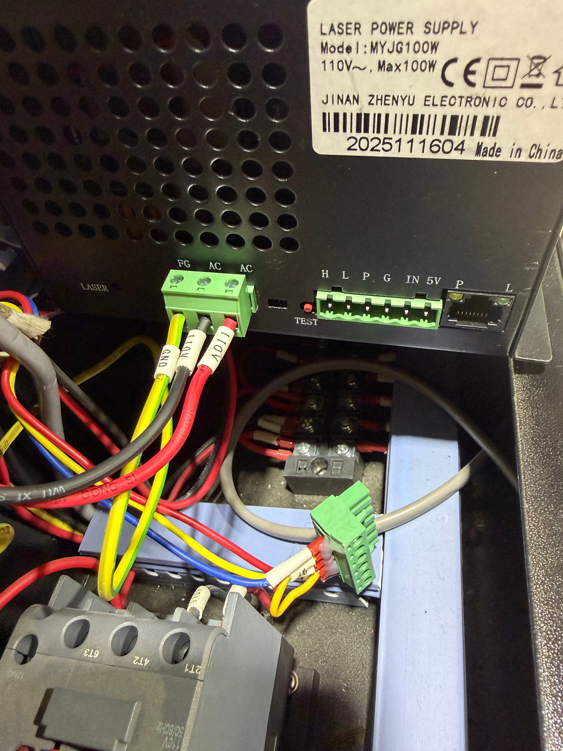

Here is a picture of the wiring on the LPS. The black and red both go to the main relay on the unit.

The relay terminals are another good place to check the voltage on the power supply wires. :high_voltage:
The power supply data plate shows it’s a 110 VAC unit, so one wire should be 120 VAC and the other about 0 VAC with respect to frame ground.
In reference to GND both of those wires have 120V.
That’s why the power supply doesn’t light up: the wire that should be Neutral is either hot or disconnected.
Because the voltmeter presents a very small load = very high resistance, a disconnected wire can float “high”. If both wires are connected properly, the voltage reading will be correct.
The wire colors are meaningless, so you must trace them back to their source. At some point you will measure 0 V on one side of a switch / relay / terminal block and a different voltage on the other side, both measured to frame ground. Whatever is between those two points is the problem.

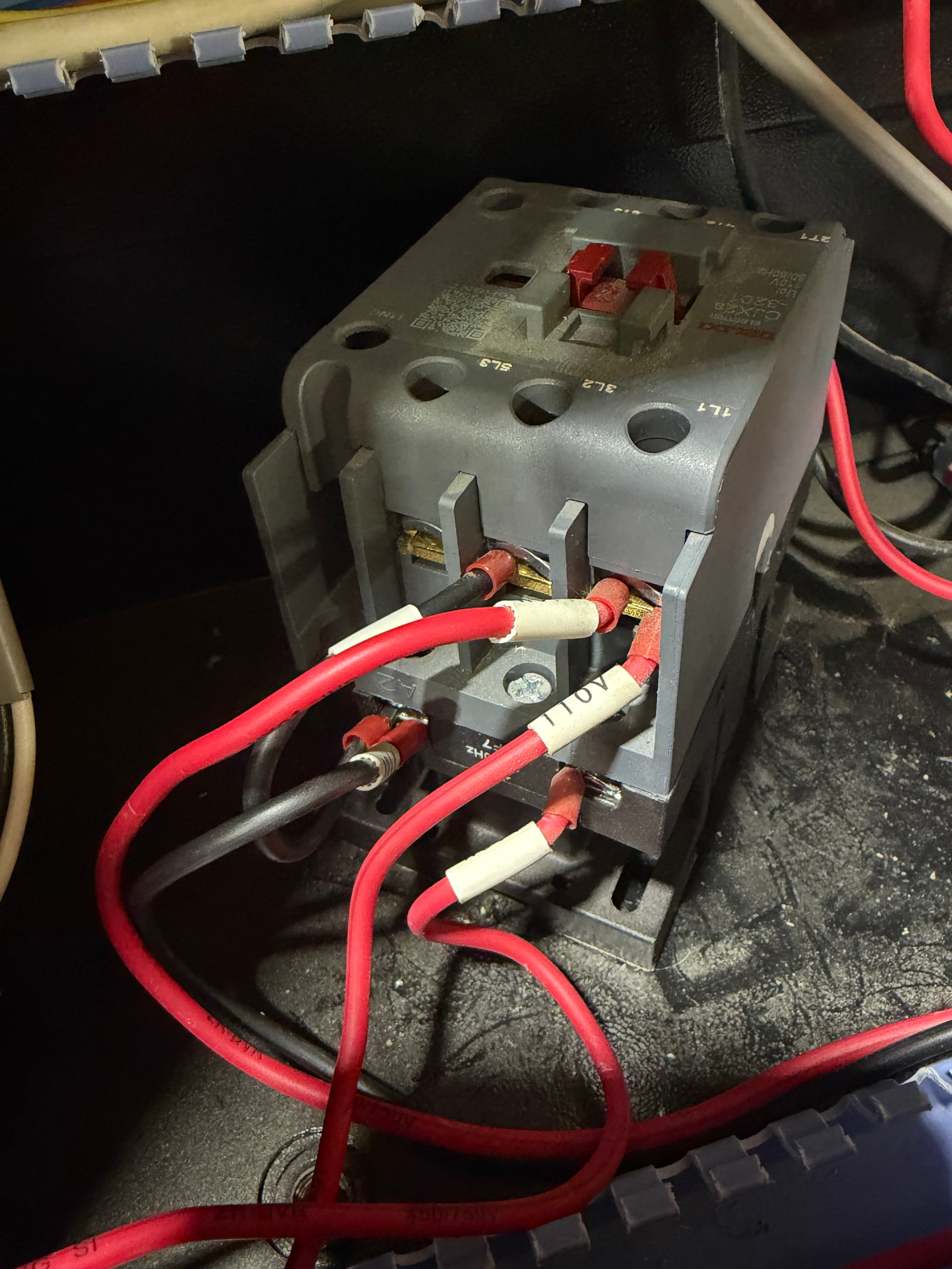

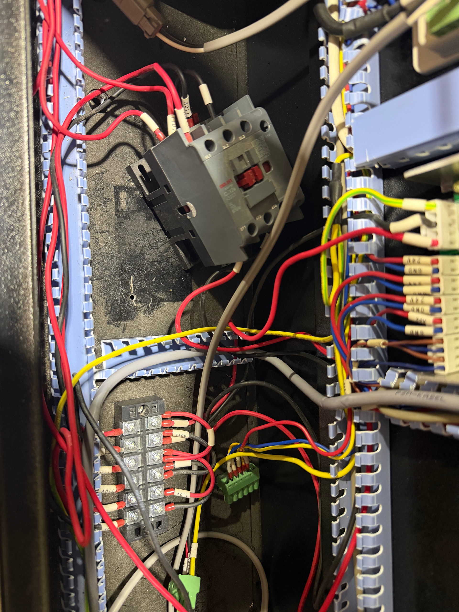

So I am now leaning towards the contactor. I did some continuity checking and I am getting continuity between A1 and A2 on the relay for the contactor. So my buss bar are all connected now also.
There’s also sometimes a fuse hidden in the power cable port on the exterior of the laser itself.
A1 and A2 on the contactor should always have continuity, usually around 300-400ohms for 250VAC, so probably around that half that for NA.
If you have 0 ohms (or similar) it’s a short. If you have OL, the contacts are broken.
I checked the Ohms and was getting 104 Ohms between A1 and A2
It sounds and looks fine. (other than I’d combine some of those ferrules but thats not relevant to this) Contactors are very simple, they are just switches.
If you want to check if it’s working fine, remove all the wiring. Put voltage across A1 and A2. Listen for the click. Remove the voltage. Listen for the click.
1L1 and 1L3 shouldn’t have continuity. Nor should 2T1 and 2T3. 1L1/1T1 and 1T1/1T3 will have continuity only when 110V is applied between the coil (A1 and A2)
