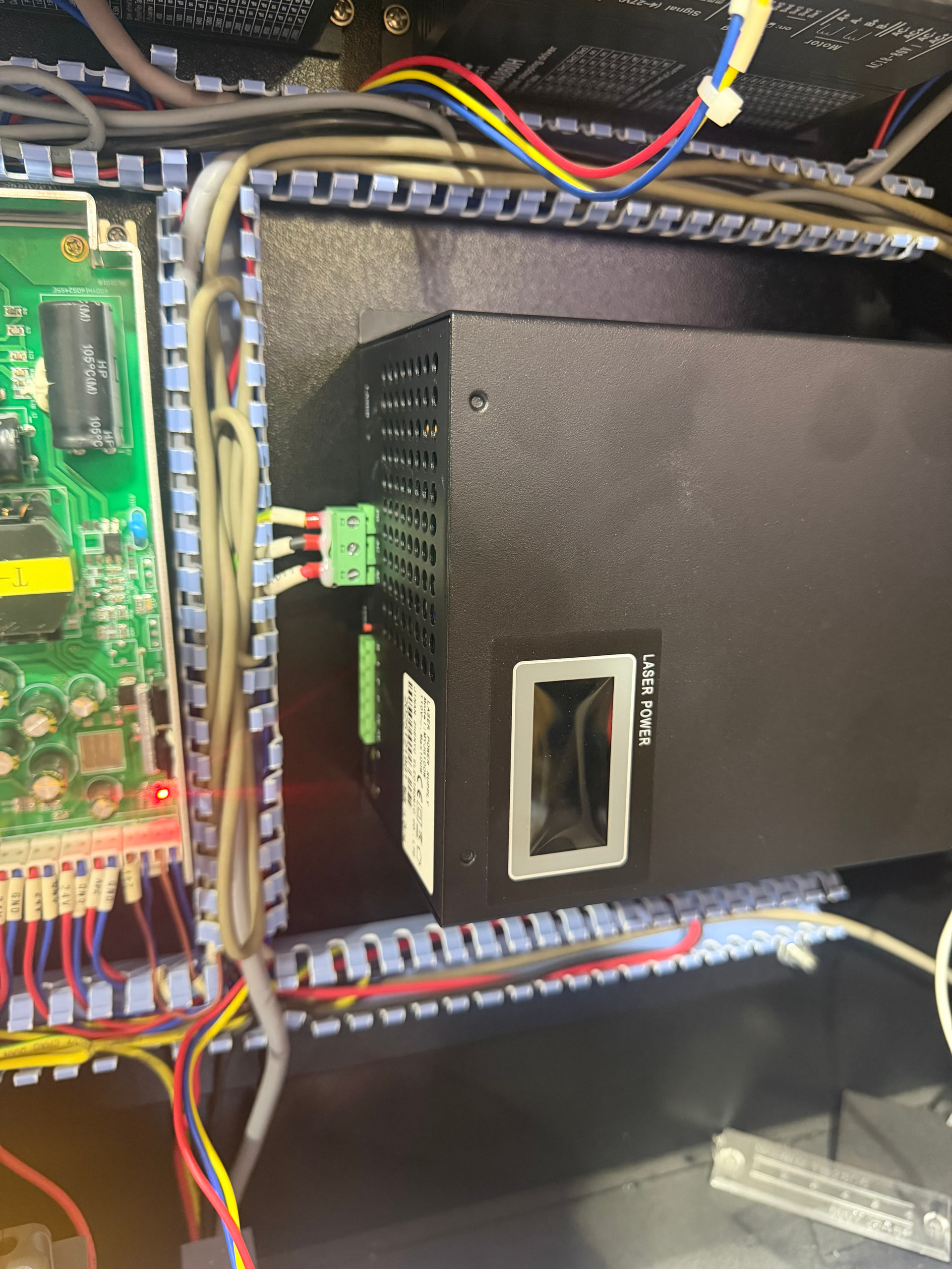

I have an Omtech 100W laser and was in the middle of a burn when the laser stopped firing and the laser head continued to run as if there were no issues. (I could get the laser to run the burn again and everything would move but the laser would still not fire)
I looked at the LPS and the screen would not come on. I unplugged the controller connector and hit the test button and it would not fire. I checked voltage and was getting 120V at the LPS. I checked all of my interlocks (e-stop, lid, and water) and everything looked good.
So I ordered a new LPS and plugged it in and still could not get the laser to fire. Having a bad LPS out of the box is not impossible but highly unlikely. The new LPS screen does not turn on and when I try the test nothing happens.

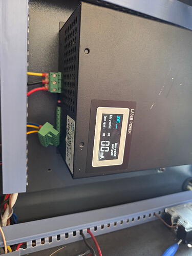

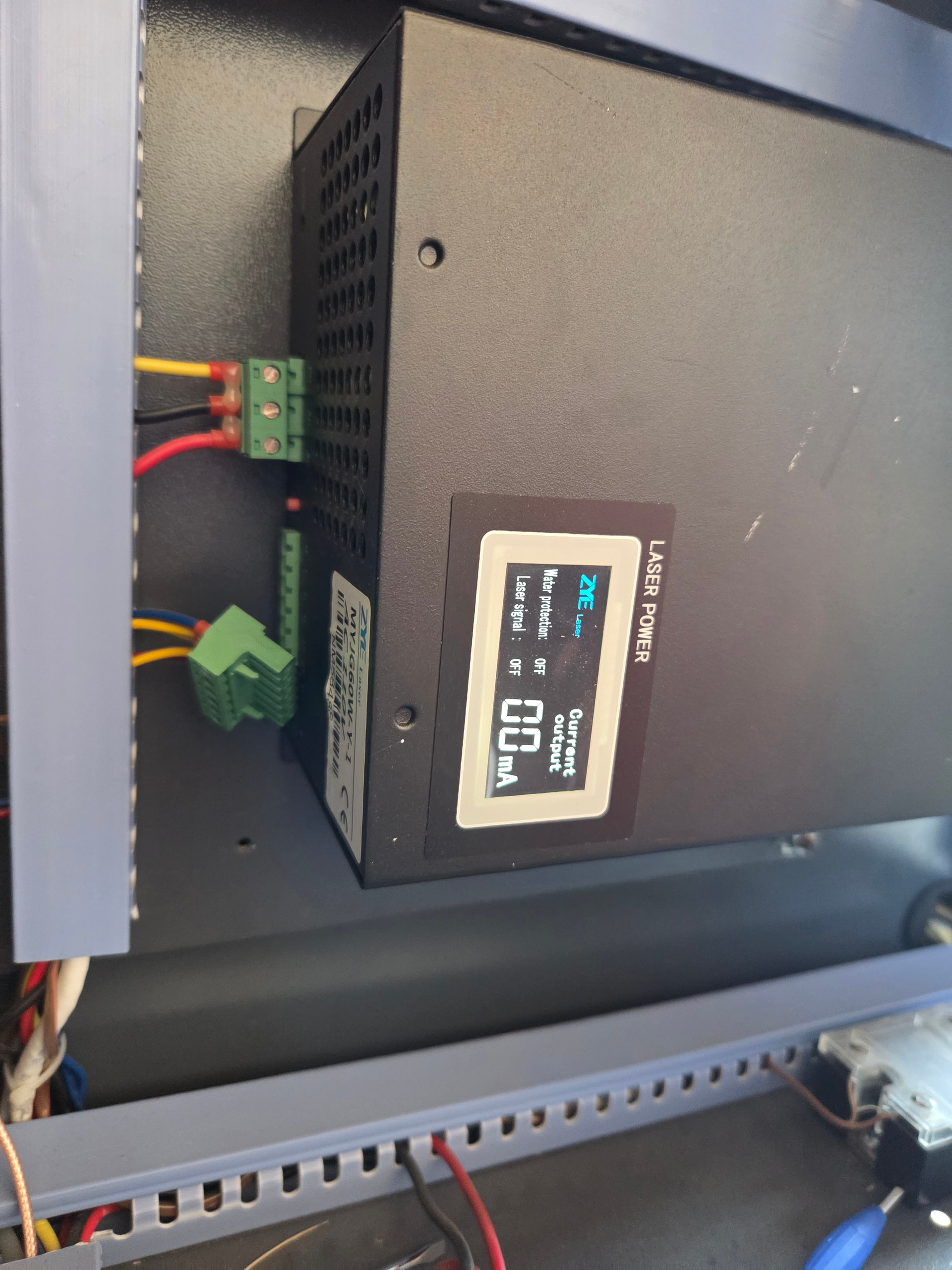

Here’s a photo of mine, control signals removed and powered on.
I guess you can see for yourself.
