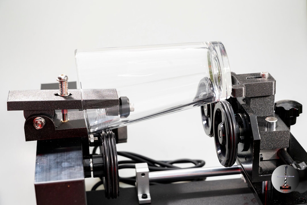

I am trying to use my rotary device but everything keeps walking off it. Am I missing something? It walks from one end to the other. My rotary device on my xtool does not do this. But it does have a chuck. It is like its missing a holder or something.

I have a PiBurn 3 wheeled (roller) type. It has hold downs and such to help keep the item from walking. Some people also put heavy socks full of sand or something to help keep them in traction with the wheel.
Most often the axes acceleration settings are too high for a rotary… there is little traction and it’s exacerbated by trying to move (accelerate) the mug too quickly…
Check the wheel alignment … if it’s off at all it will walk… what how tires work…

I am talking about the 4 wheel rotary that Omtech sells. I will check the wheel alignment again. To make sure.This unit does not have a hold down. I think it really needs one. Should I just write it off and get another chuck unit for the Omtech? Like I have for my xtool. As I read up on it. Sounds like a lot of problems from people on this type unit. I have looked at hold downs I can add but don’t like drilling into it. Just looking to see if there are other options. Thanks

Most of these designs require the mug ride against something, like the belt case to keep them on the machine… Any of these out of alignment will cause the mug to walk off…

I’d get it rolling back and forth and look at the mechanics… It’s got to be some sort of wheel alignment issue, maybe one is higher than the other…? I don’t know what all can go wrong but it has to be pretty limited.
That’s different than a traction issue where the mug stays aligned, just slips on the rollers.

Well there is nothing for it to ride against. I looked for that and anything I could put there to act as a stop on both ends. It does also have a traction problem. I went ahead and ordered a rotary hold down for it. I don’t like having to drill and mount something on it. It is new out of the box. But don’t see anyway to make it work. It seams to be built well. Just not thought out very well. I am going to go back to the shop tomorrow and recheck the wheel alignment one more time. Thanks for the ideas. If you think of anything else, let me know.

Thanks for the heads up. I am waiting for the hold down to get here. I rechecked the wheels and everything looks right. I am thinking about getting a chuck model like the one I use with my Xtool. Is the one the Omtech offers a good one. Has anyone used it?
OK it is a lost cause. I got the holder in and the screws will hit the belt. There is one that uses the belt tighting screw but he must have stopped making it. Phillip and Jack thanks for trying to help. So I am open to new rotary ideas. Can anyone tell me what is a good one to use with Omtech? Open to any suggestions. I think I want to go with another chuck model like I have on the xtool. Again thanks for trying to help me get it working. If I have learned nothing else. It is when to stop before I lose it and do something stupid.
Just an update. I found another hold down on esty. It worked great. I even moved the wheels a little out of alignment and it still worked.He gos by BladesAndBeams. This thing works.
