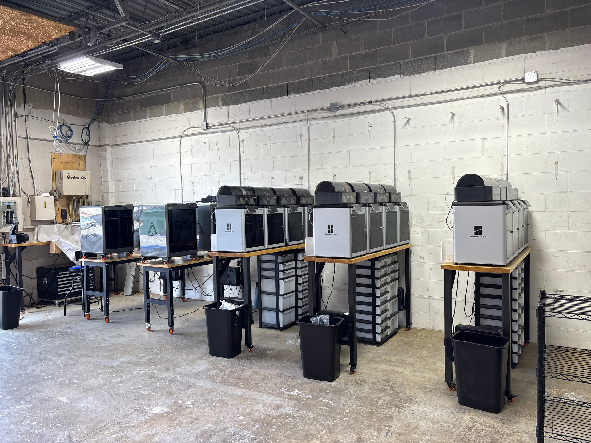

My M2 is long gone. 3D printing has turned into a thing for me though. Thanks again for the assist.
An industrial thing!
:astonished_face:
