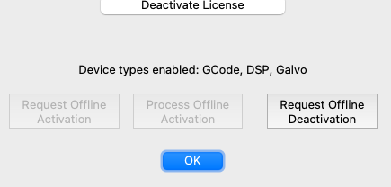

Ive had my Omtech 50 watt jpt split fiber laser for as few months now. Never had connection issues with lightburn until a few days ago. My software wont recognize that the laser is connected. It says “disconnected”, however I can see my laser camera displaying in lightburn. I have no issues when I use EZCad, but i already paid for lightburn and its much more user friendly. Any help would be appreciated. Omtech customer support can’t figure out the issue. It may also be worth mentioning that the laser has not connection issue when i was running the free trial but when that expired, and I purchased a key thats when I stopped being able to connect my laser.
Which License did you purchase? If you purchased Lightburn Core, it will not run your fiber, you need Lightburn Pro for that. In Lightburn, go to help menu and click license management, that window will show which device types your license supports. If yours only says GCode, you have the wrong license.
Mine says GCode, DSP, and Galvo just as the picture above.
Well, that’s not it then. Someone else will need to chime in.
