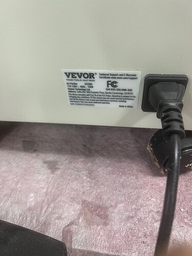

Hey friends. I picked up a Fume Extractor from omtech, but i can’t for the life of me figure out what model it is. I have only used it for a few hours total, but the alarm is telling me there is a bit of an air obstruction. I have swapped the cotton filter, and vaccumed the pp filter under it, but i’m still getting the alarm. So I was shopping for new filters, but can’t find any based on the info I have. The website also has them listed as out of stock. Filter size is 14.9x10.9x2. I’ve searched for that, and haven’t had luck there either. I could use some help after several hours of trying to problem solve this. What are y’all using? And what model is this? The manual doesn’t say and there isn’t a sticker I can find. Frustrating.

I think i have the same one with a different brand name. Its an VEVOR XF250U.
They all take the same filter set. And Omtech sells the filters.
Here’s a link to the filter set:
Replacement Filter Set for XF250 Fume Extractors – OMTech CA
You can also buy just the primary or charcoal filter separately here.
The stage one filter is just 1/4 microfibre and you can make your own. I bought a roll but i dont remember where
