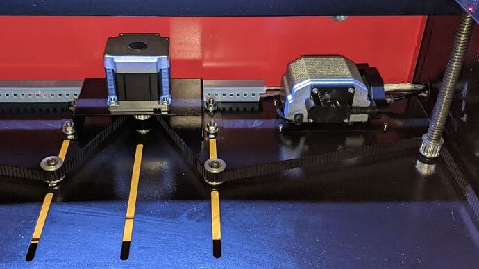

I started with a 12x20 50w machine that had the external fish pump. I was using it outstandingly until I found someone with a red machine in a 28x20 work space and they wanted to trade straight across as they needed a smaller machine. The machines are basically the same save for a few things, like the air assist. The new machine has an internal pump, but it’s much smaller.
It barely moves any air compared to this style of pump I had before https://a.co/d/hiuM76v
I know some of the newer blue machines have this larger pump internally as well, is there any gross differences or can I simply buy a 1080/1500gph pump and wire it in place where the smaller 30l pump is? I really don’t want to plumb in a compressor line at this time. I’d like to just clip the plug off, splice and go.

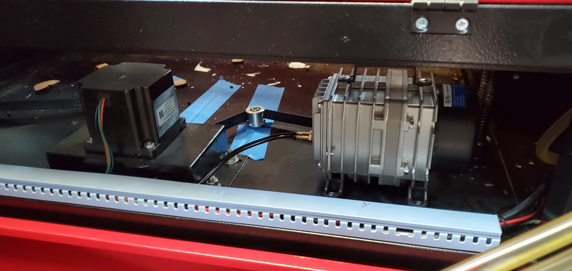

Here’s a video I followed. My pump went out and could have burned the whole place down if I wasn’t standing there.
The upgrade made a big difference in the quality. Really surprised me.

Which still leads me to my original question, is the internal wiring sufficient to wire this thing in place without much issue? Which based off your picture, it looks like ot should be but there are a few differences between the red and blue machines as I can tell so far.
Probably why it’s still in my junk box… :crazy_face:
These are generally wired in place, so I doubt you’ll have any issues.

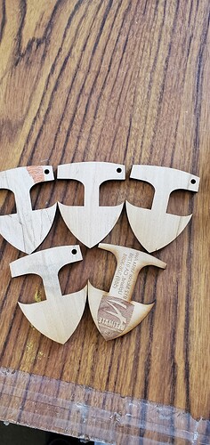

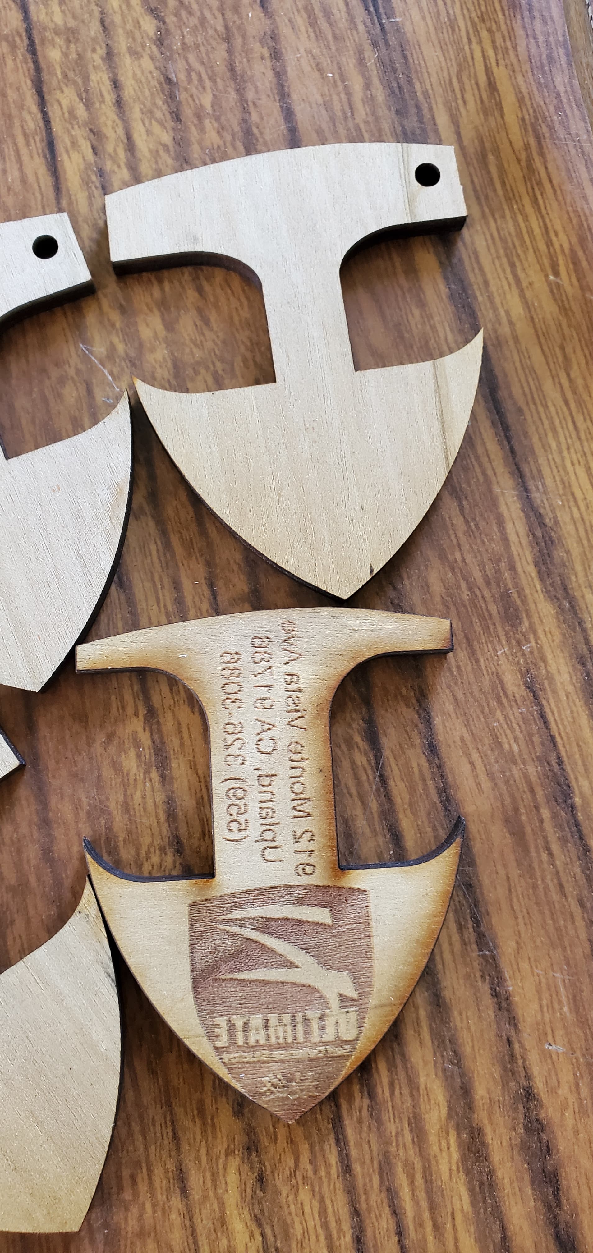

So I know this isn’t considered an “upgrade” for the folks here but the $14 90lpm was a significant upgrade over the 18w version of the same pump I had before.
Here is the piece I cut with the 30lpm pump vs the 90lpm. I’d say for the cost invested and the 20min it took me to swap it was worth it for me. Zero scorching on 1/4 oak cabinet plywood
