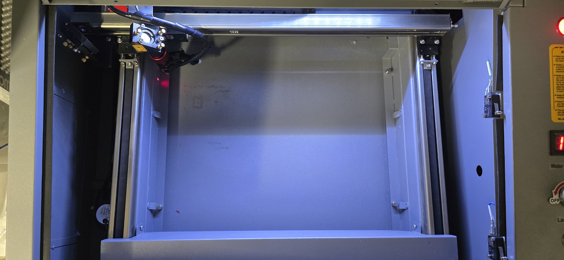

I bought a K40+ from omtech uk just over a week ago, it has a production date of 19-11-2025, and has a fully sealed base :
in fact it’s too well sealed so it’s hard to extract smoke, as the only way for fresh air to enter the box to replace the smoke sucked out is through that small round hole in the wall of the power compartment, and the tiny gap where the finger depression is to lift the lid.
There is a single hole in the base and that’s below the air assist pump that’s mounted to the left of the gantry (you can just see it’s while label in my picture)
this is to let it draw in fresh air from outside the case, no laser light can escape that hole as the pump’s housing covers it.
This air pump is just a fan blower, it’s better than nothing and allows people to use this machine without having to buy and plumb in their own air assist system… which is the point of the K40+… half the shortcomings of the basic K40’s have been fixed when you buy it, for those who don’t want to spend weeks upgrading the machine before they can use it properly.
As for easily defeatable safety mechanisms, it’s got 2 microswitches on the lid, the first one trips if you lift the lift more than 1mm,
this shuts the whole machine down, so the gantry stops moving, laser turns off and it sends a ‘machine stopped’ error message to lightburn,
To get the machine running again if you do this, you need to fully lift the lid so that the 2nd switch opens and trips the 2nd safety relay, then you can close the lid and press the reset button (below the key switch to ‘arm’ the laser)
And then you can resume / restart the program from lightburn.
I don’t get what is easily defeatable about that, any safety switch can be held down by someone who wants to do so,
if it was a hall effect switch they’d use a magnet,
some more industrial lasers have a car seatbelt type switch for the lid where a metal ‘tongue’ piece enters into the switch housing to operate it… people grab an offcut of 3mm wood / plastic and push that in the switch to defeat it when aligning the mirrors.
There’s only so much you can do to idiot proof things, people will always find a way to defeat any safety system, so the only real solution is to ban home users owning laser cutters and make them industrial machines you need training and insurance to use… like some places are trying to ban 3D printers because someone might print a gun on one :roll_eyes:
I’d consider this machine safer than the original K40’s that often had no safety switches, if they did they’d have no interlock that locks the machine out when tripped requiring a specific reset procedure… which is a pain for anyone used to using other laser cutters where you can align the workpiece with the lid up, on this machine the gantry won’t move unless the lid is closed and the interlock reset button had been pressed.
