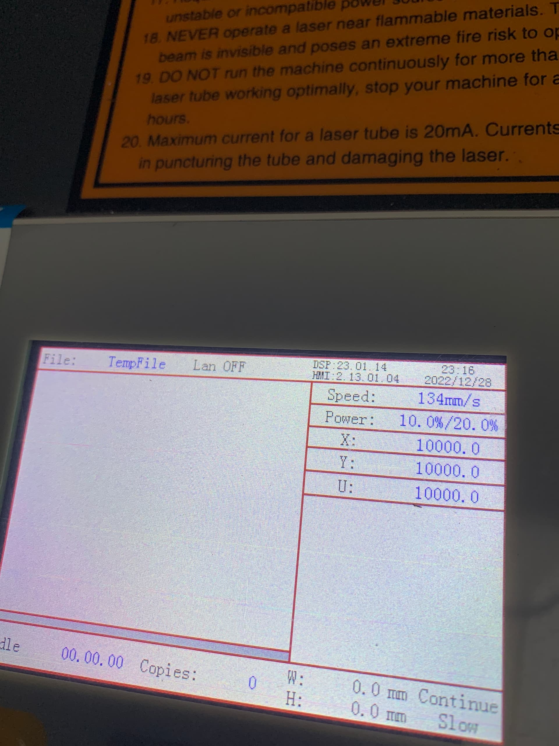

I upgraded to the 1.3.01 and started my job but half way through on the start of the line cut it went of point and started cutting across the same area so I stopped the job and there was an awful grinding sound on my Y-axis and it wouldn’t work anymore it was grinding and the control panel read the home instead of 0.00 on each it said 10000.0 on all axis points on the control panel.

I have just started a new job on it after finishing one and its at it again in the start of the new job it was just going over and over the same area and this time its the X-axis that is grinding. Again I haven’t changed any settings and the control panel reads my home as 10000.0 across the X,Y and U

The first thing a Ruida does it home, if enabled.
If it can’t home on an axes, that axes is set to 10000. If homing fails, both axes are set to 10000.
Place the head in the center of the work area, and power it up…
Does the head travel in the proper directions to home?
You can press ‘esc’ to stop the home function and give control back to the machines console…
If your machine is displaying 10000 on an axes, it hasn’t homed

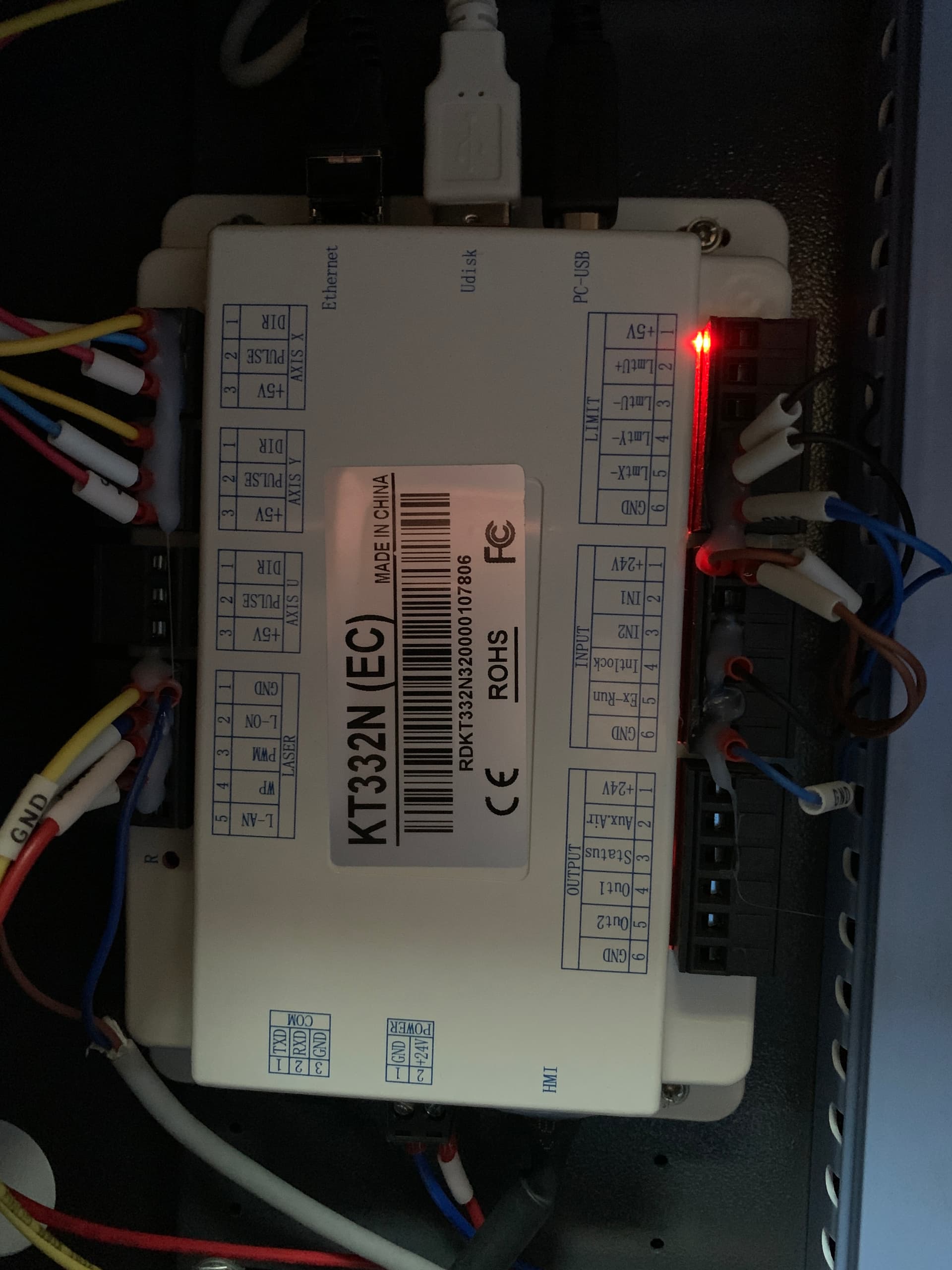

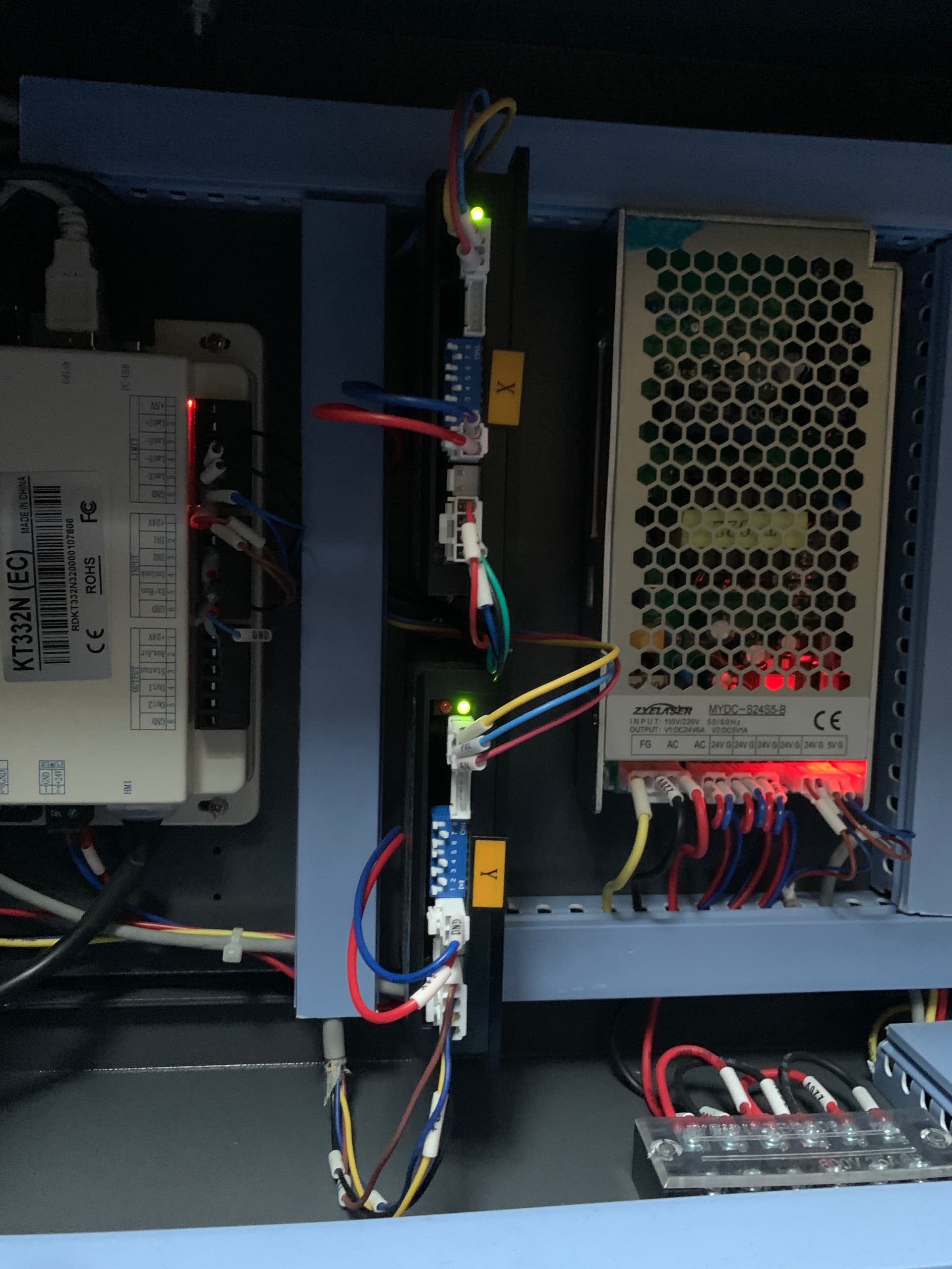

Check the electronics cabinet for a ‘red’ light on any of the motor drivers or an ‘err’ condition (led 13, I think) on the Ruida.

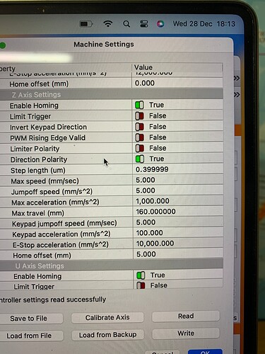

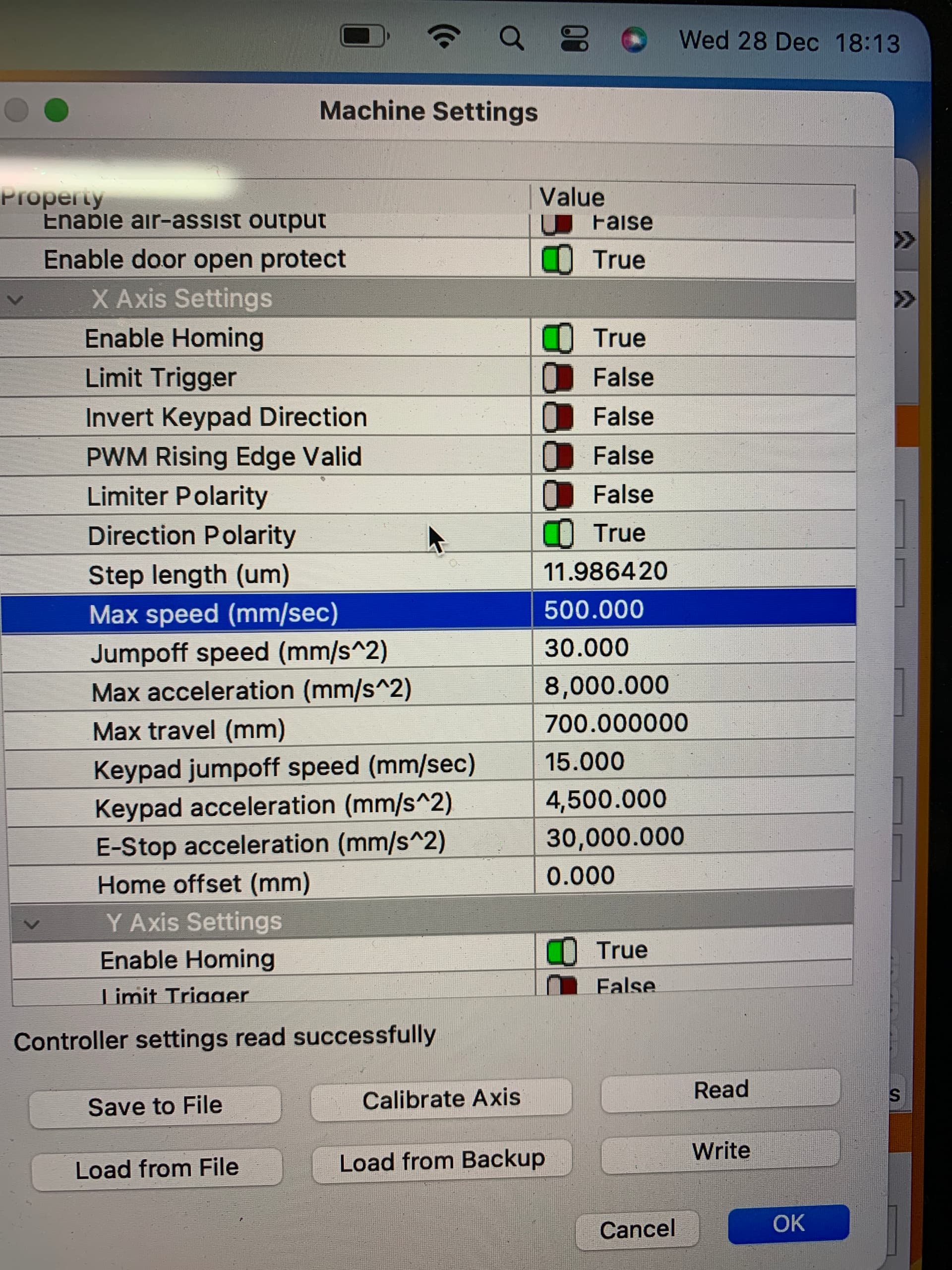

With the power on, use LightBurn to examine the speed and acceleration for the Y axis. There is no reason for those values to change without notice, but it’s worth checking. They should be close to these:
If all those tests pass, then the debugging gets a bit trickier. Report back with the results!
I disagree with @ednisley here, don’t mess with the configuration until there is good reason to suspect it, which we have none… this may introduce other issues. If it’s changing on it’s own the controller is broken.
It is a good time to save it, if you haven’t already.

I powered off and moved the gantry to the top right where it would normally home. The controller reads the image I uploaded before that the X,Y and Z are at 10000.0 when they should all be reading 0.00 that is the only significant change that I see has happened. But I haven’t been in or changed a single thing on it.

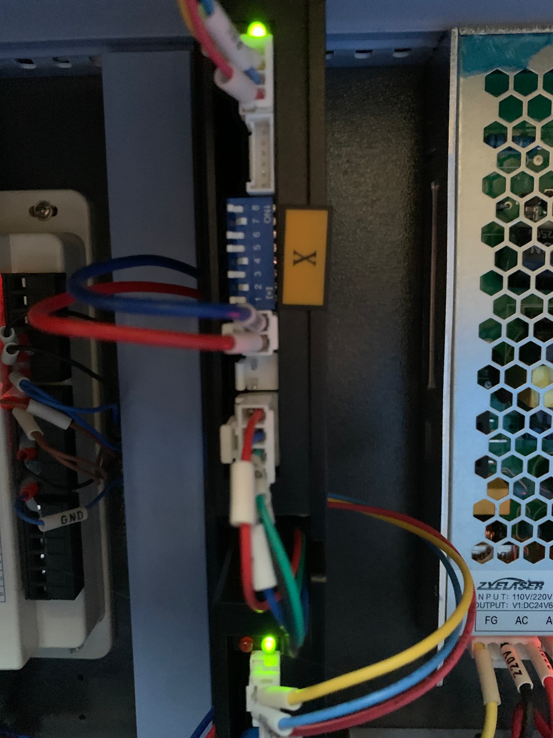

Did you check the motor drivers for errors (red led is hardware)?
If you want to modify the controller, have at it… It hasn’t been show to be an issue and I don’t want you to possibly add another problem to the one you already have.
Was the Y axes on it’s ‘home’ switch (active) when you photographed the diagnostic panel? When you trigger the Y home, does it show up on the controller AND on the Ruida controllers console as active. Does it show ‘inactive’ when the switch isn’t being triggered?

However, in recent days we’ve seen enough weird cases to at least want to know those settings remain valid. From what I can see, they’re just fine, so there’s no need to mess with the controller.
That’s good to know, as it eliminates a whole bunch of other issues.
Knowing the controller settings are good, suspicion now falls on the Y axis driver or the connections between it and the motor.

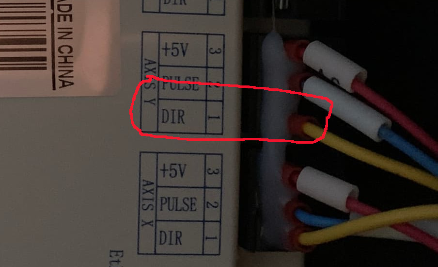

It looks like the directional control to that axes is not changing.
If you move the gantry to the front or middle of the machine, does it only move towards the rear?
I’m trying to figure out if towards the rear is the only way it will move with the console.
If it only moves towards the rear, there is a signal to your motor controllers that specify the direction of travel.

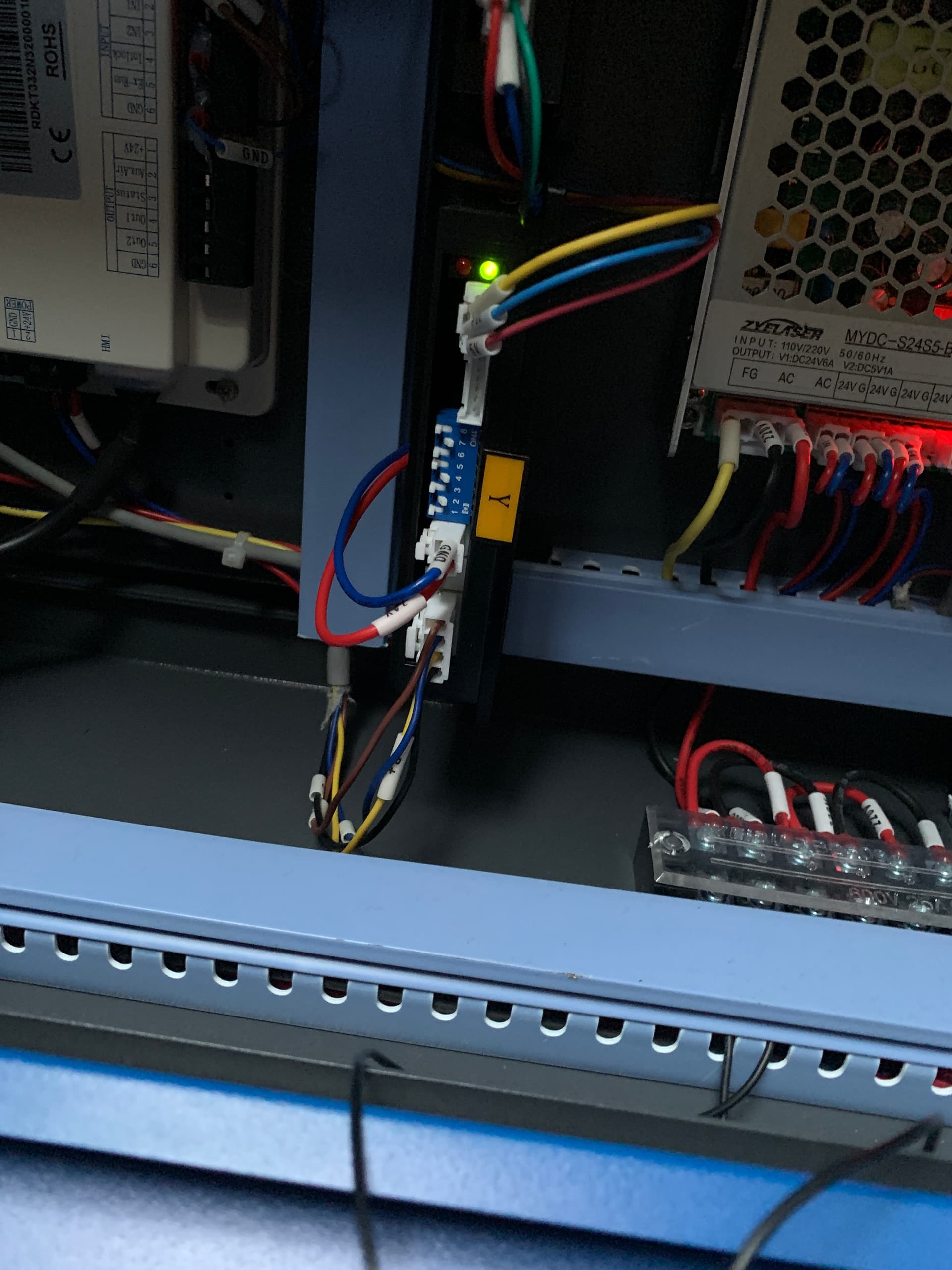

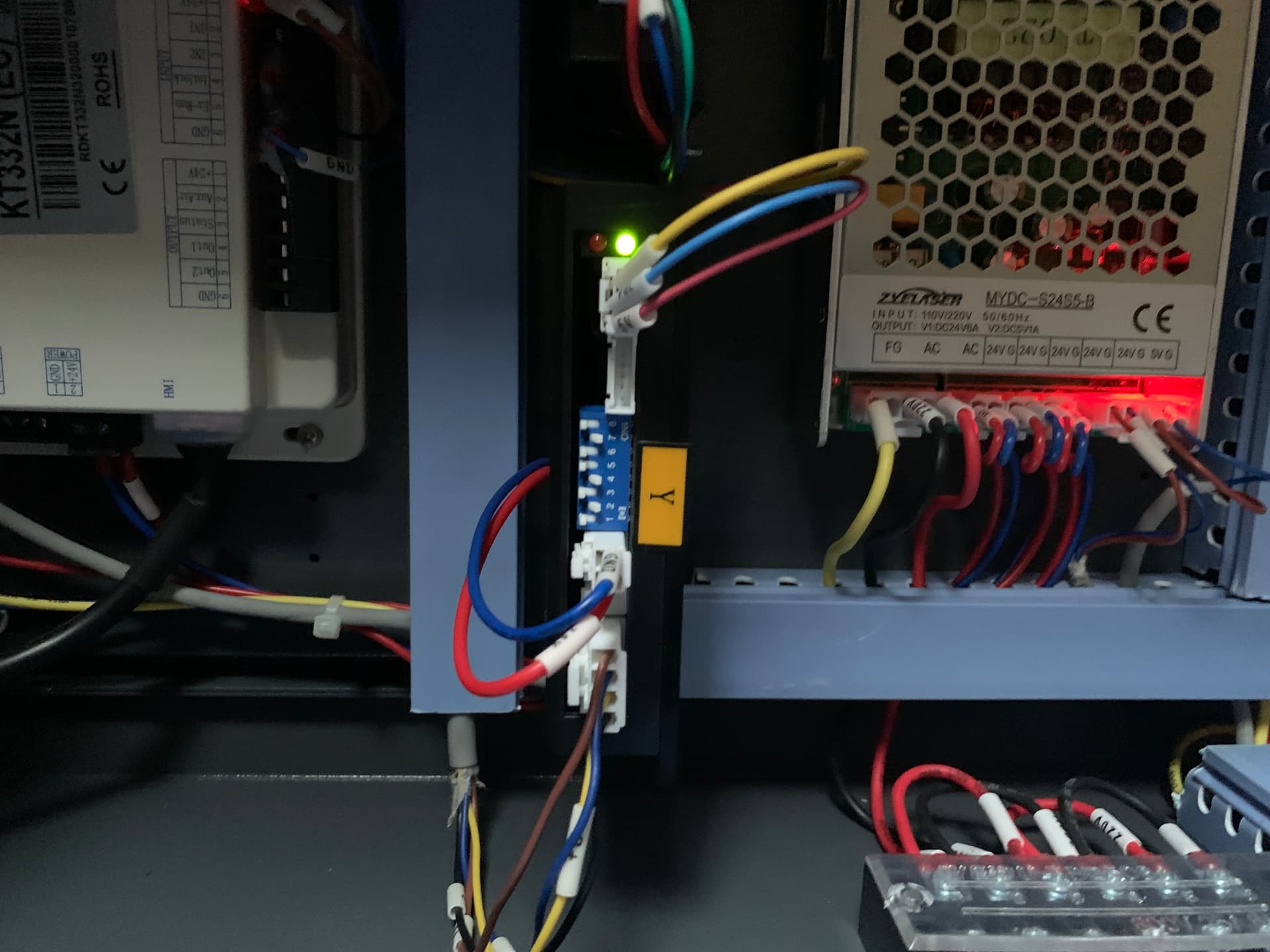

A picture of the Y motor driver would be good… nice photo of the X driver, but that’s not the issue… Been nice to see them both.

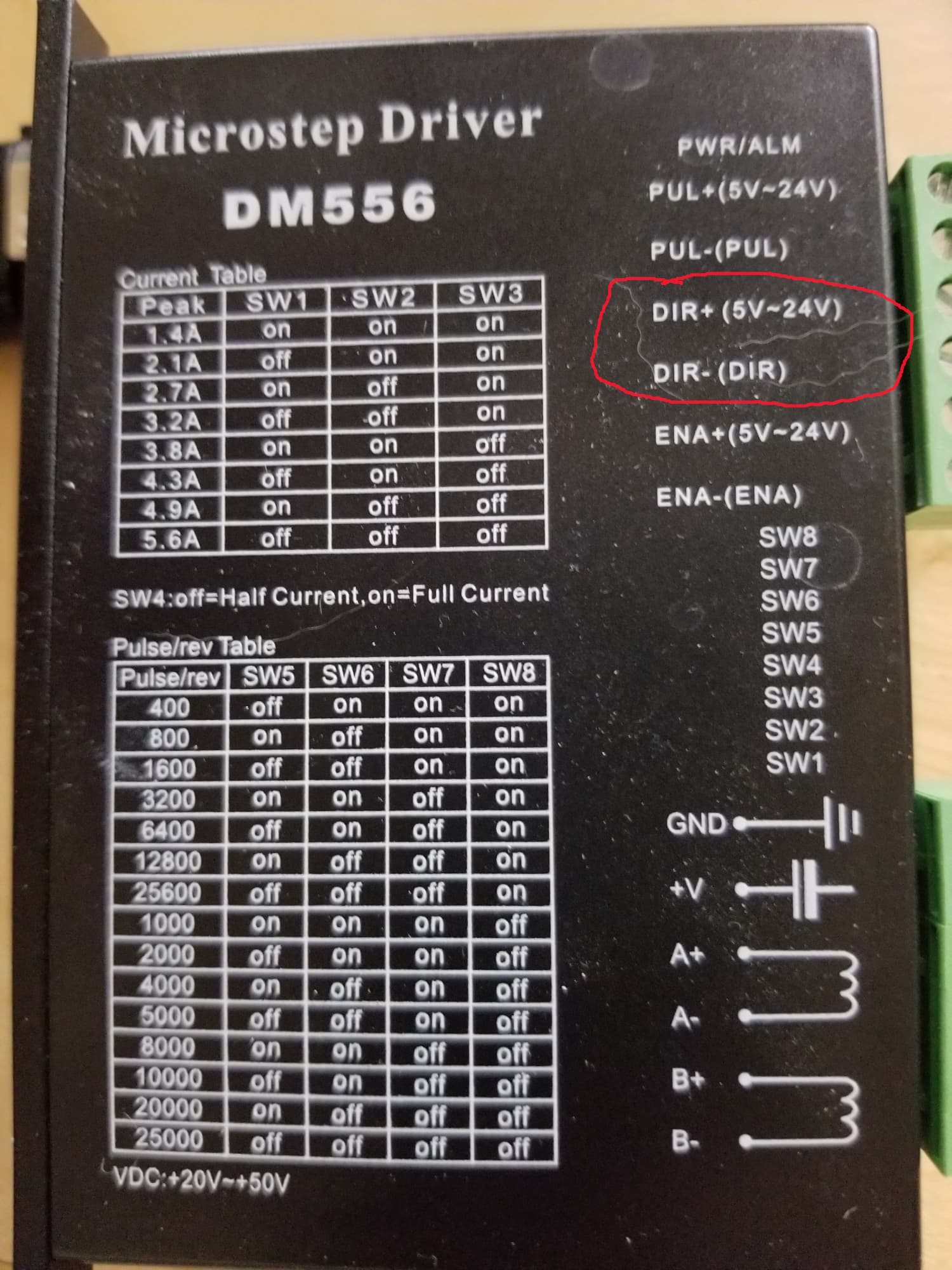

I’d suggest you ‘gently’ tug on the wires where the ‘dir’ input is and also on the Ruida, the source of the direction signal. Sometimes these are held only by glue, didn’t get screwed down… Make sure the connectors are seated…
Don’t change anything, just check… your motor driver may have a different pinout… they have a placard on one side, like this…
This is ‘dir’ origin…

Im sorry I just missed to upload the Y-axis photos too when I uploaded the others :relieved:
I am going to email OMTech today
I have checked the DIR lead in the Y-axis panel and the wire is held in there with glue and fully seated
