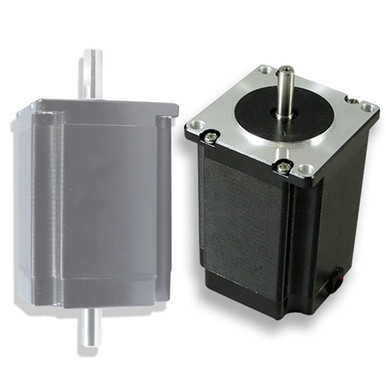

What type of motor is it?
These are NEMA based, a NEM17 it 1.7" on each side ā€¦ a NEMA23 is 2.3" on each sideā€¦
Itā€™s got 4 wires, so itā€™s a two phase stepperā€¦ These mounts are standard as is the motorsā€¦ It should be a simple swap out for a new motor of the same size.

I had the same experience when checking that part number. The main things youā€™d be looking for:
  1. Itā€™s almost certain that the motor is a NEMA 23. This defines basically dictates the size of the faceplate and the location of the mounting holes. NEMA 23 should be roughly 2.3 inches square at the face. The mounting holes will be 47mm apart center to center. Measure yours to confirm.
  2. You will need a dual-shaft model
  3. Shaft diameter, shape, and overall length will be important to couple with your existing setup.
  4. Will be easiest to stick to a 4-wire bipolar motor for wiring simplicity
  5. Look for one rated to 3.5A or slightly higher as that is how your driver is setup.
If you talk to someone at the shop they should be able to confirm fit for purpose and swap-in replaceability.

Iā€™ve gone for this one as itā€™s the closest I could find to my measurements I couldnā€™t find one with any higher amps
Nema23 Dual Shaft 8mm 6.35mm Stepper Motor 56.4x56.4x56mm 1.3Nm 3A
This hybrid bipolar Nema 23 stepper motor with 1.8 degree step angle (200 steps/revolution).
Double Shaft Nema23 Stepper Motor (23HD4404-25S)
Specifications:
Motor Depth: 56mm Phase: Two phase 4 lead wires bipolar stepper Step Angle: 1.8 degree Rated Current: 3A Rated Voltage: 3.3V Holding Torque: 1.3N.m Dual Shaft: Front 8mm Flat 18mm and Total Length 25mm, Rear 6.35mm Flat 15mm and Total Length 20mm Black n Green, Red n Blue are phase A n A-, B n B-

That motor has a rear shaft of only 6mm, yours is 8 both ends? so youā€™ll need a 6-8mm reduction sleeve.
The 4-wire version of this would be a very close fit:
Thank you I have been trying for the last few days to find one in the UK with those specs and I have asked a few places over here. One place had one that was similar but they did not seem confident that it would be what I needed so iā€™m still searching. :slightly_smiling_face:
