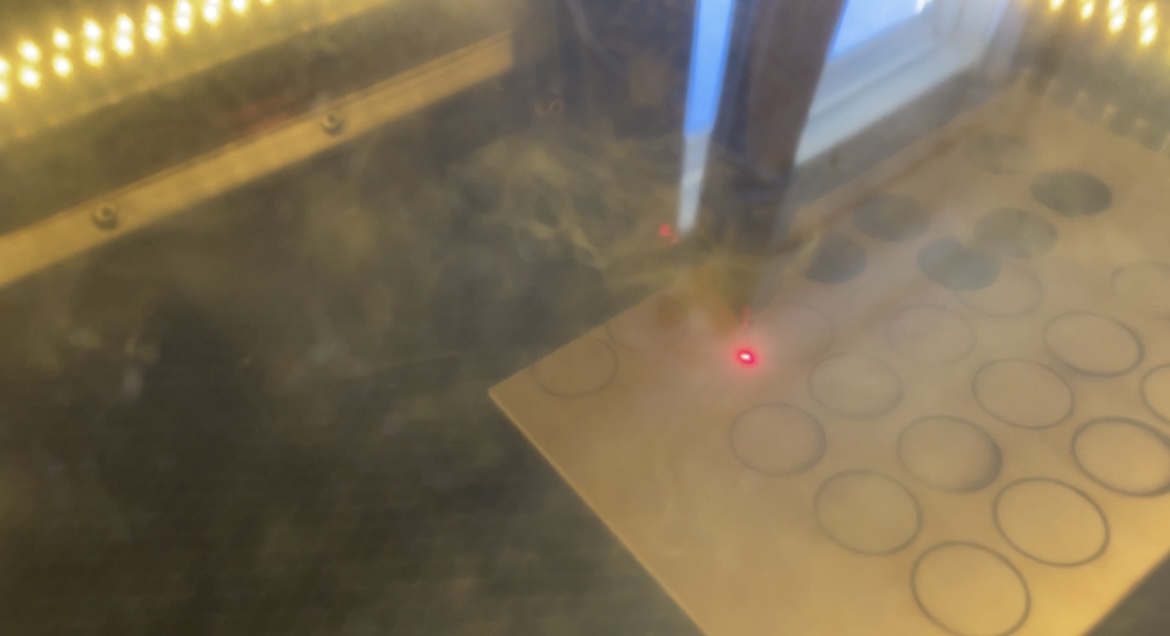

Hello all!
I have been racking my brain and trying a lot of different ways to vent the fumes/smoke from my machine. I have a 55w Omtech Laser with 16x24 bed. My machine is indoors in my office. I do not have the stock exhaust fan anymore, and have upgraded to 6" inline duct fan with 400+ CFM like most people suggest. My honest opinion is that it does not extract the fumes like I hoped it would. If I am cutting wood for example, the whole machine seems to be filled with the fumes/smoke until it stops cutting and sits for a minute or so.
My last option that I am thinking of doing is either A) Cut a hole in the top of the lid to run another exhaust tube or B) remove my pass through door to custom rig an exhaust fan to go through there.
My main goal is to keep the fume smell out of the house.
I am not sure if I am not thinking of something, or if anyone else has dealt with this. Any help or ideas would be great!
Side note…I can include pics and videos if that helps.

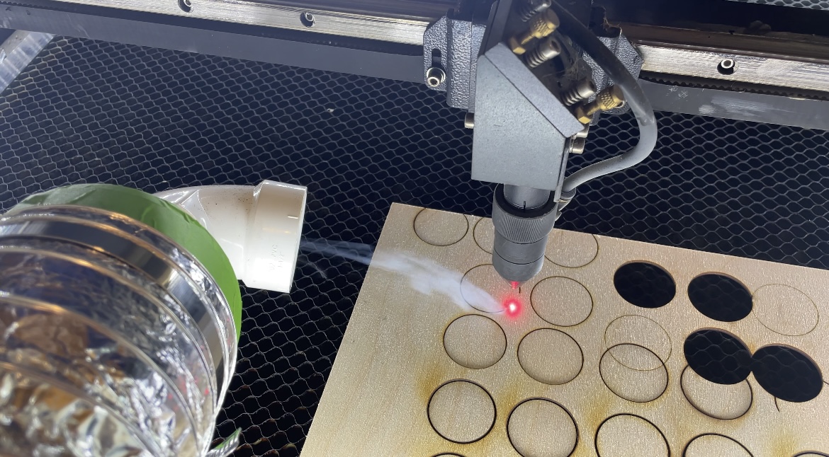

Here is where I have a pic of normal exhaust filling with smoke. The other is with a less powerful fan closer to the engraving(cabinet open) and it does wonders. This is partly why I was thinking of drilling a hole in the cabinet lid to run an exhaust there.
