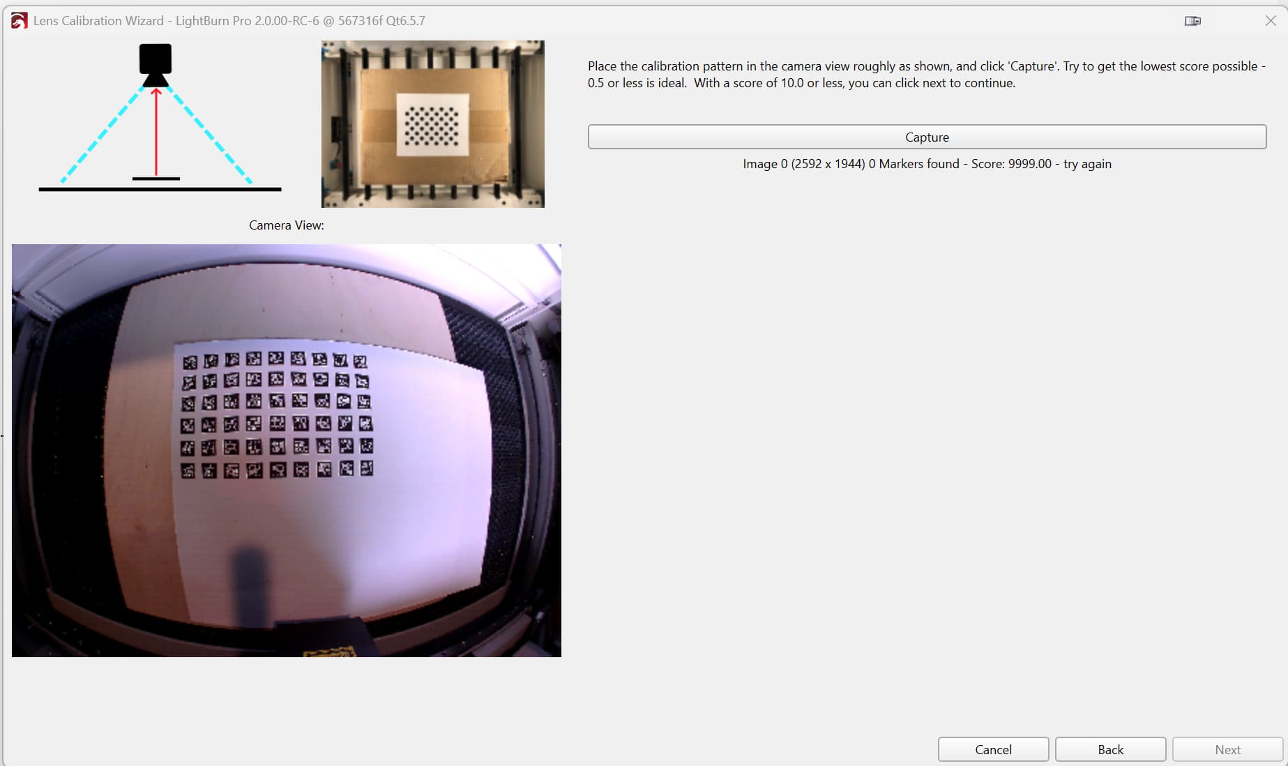

New to lightburn and lasers in general. Just purchased an OMTech Polar+, and while the laser component works just fine, I cannot get the camera lens calibration to work at all. I’ve tried the latest stable lightburn as well as the most recent 2.0 release candidate, but no dice.
I’ve tried basically everything I’ve seen on this fair forum on both versions:
  • Fallback/Default camera capture system
  • Current lens calibration system - with both circles (with and without honeycomb check) and 4 different sizes of AprilTags.
  • Experimental lens calibration system
  • Changing camera lighting
  • Lifting camera lid and holding AprilTags various distances from the camera
  • using OBS to create a virtual camera. Just got black screens in lightburn, even though OBS itself shows the camera just fine.
A couple pictures:
Both show the image clearly enough that I would think image processing should function, though nothing is captured. There’s also 0 tags found.
Any help would be awesome!
Camera calibration especially with the camera on Polar machines can be very tricky. My first reaction at looking at your screenshots is that your calibration pattern is too large. I’d suggest printing smaller.
I’ve also found the circle pattern a bit more forgiving than the apriltags though I’m not certain about this.

Honestly, I wonder if this wouldn’t be better handled by humans in each stage. That is to say, the program captures one image and we humans do similar to alignment step and select the edges of an image. I can very easily see the pattern in the capture, but the software itself failed pretty hard to determine where it was.
This definitely doesn’t have enough distortion correction applied. Your image should at least be roughly square. This may be because you weren’t able to capture a wide enough area but not sure.
Can you confirm that you selected fisheye lens during the camera calibration process?

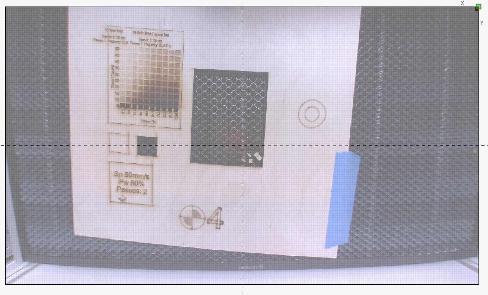

I contacted omtech yesterday and they got back to me with someinstructions, which seem to match what the lightburn docs say to do. But. They also provided me a pre-configured camera configuration file. It ain’t perfect, but it’s better than what I got from the wizard.
Attaching it for anyone else having the same issue.
camera.lbcm (775 Bytes)
It results in this:
That’s certainly better. The fact that there’s still distortion visible with the official file is comforting that my attempts were no better on a Polar.
