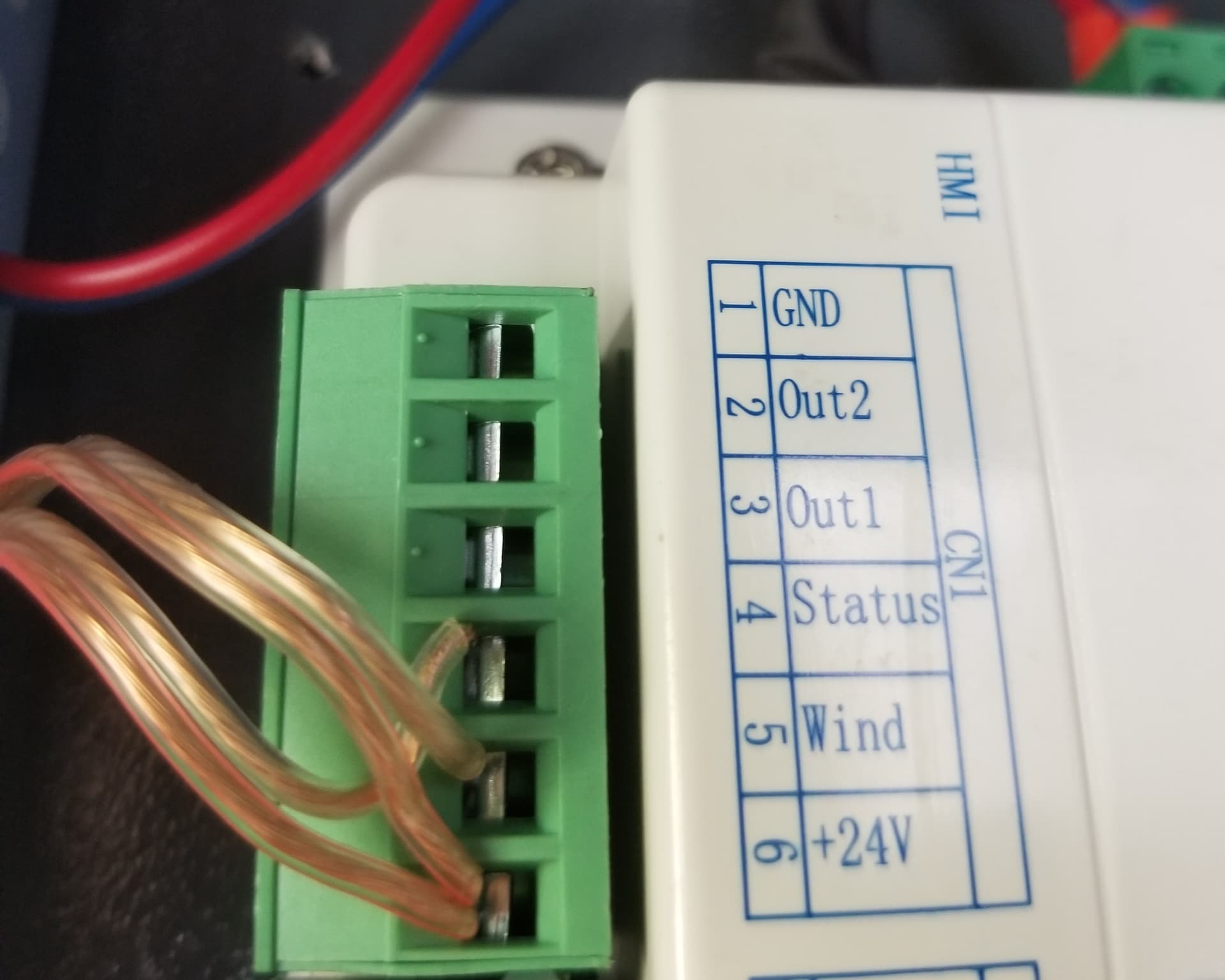

I have the OmTech Polar and it seems the exhaust fan is controlled by the air assist setting. Is there a way to change this? I would like the exhaust fan to run anytime the laser is working, and not be tied to the air assist setting.
There are a couple of outputs used by most of us with a Ruida.
When active the Status output sinks current. It becomes active anytime you run a job… The Wind sink, is active when a layer with air assist is enable and executed…
I don’t know how your fan is wired… I ran mine through a ssr from Amazon to the Status pin…
