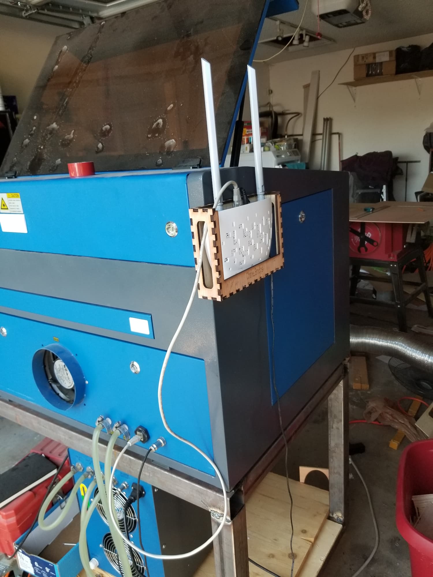

My laser is out in the garage, so I purchased a cheap wireless bridge from Amazon and I’ve been using that for quite a while.
The Lightburn Bridge needs it’s address to be 10.0.3.3, can’t remember exactly.
Don’t think theirs will work for you. Just configure the tp-link device as a bridge.
Then you don’t need an extender…
