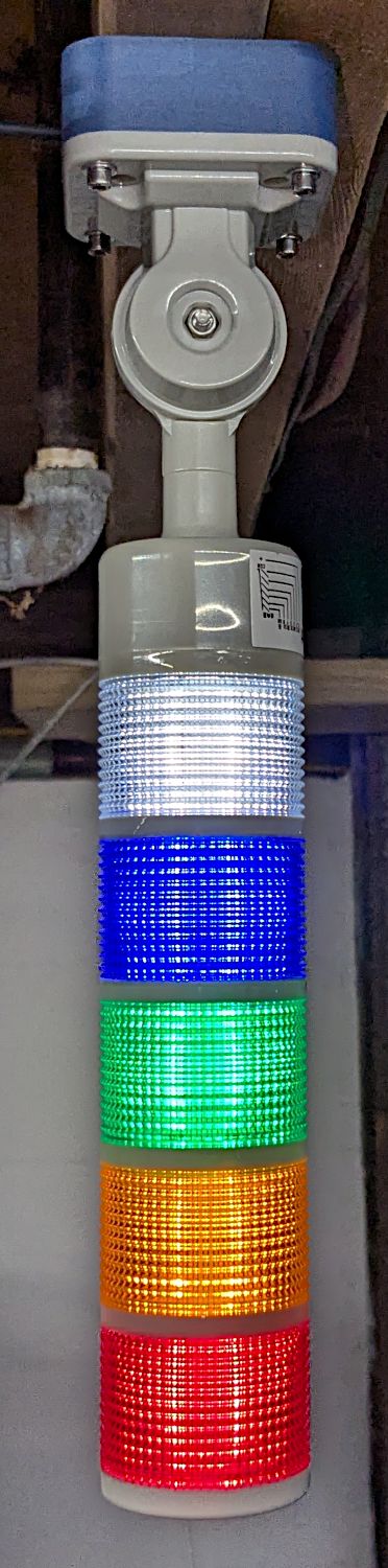

I wired an absurdly complex stack light to my machine:
When all those lights are glowin’, the machine is cookin’. :grin:
