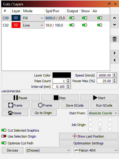

I also enclose screenshot of the settings used.

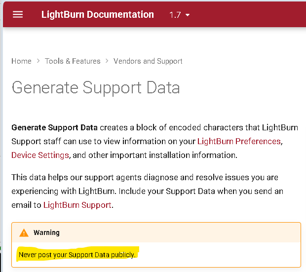

Support data should only be sent to Lightburn Support.
Here is the image you needed to see.
If this is a Fiber laser, your overscan is too great. But it is not. The Comgrow Z1 is a gantry laser.
Look at your speed setting. I am not sure if even a fiber machine can move that fast. I recommend changing it to 360mm/m instead.
How did I find it you ask? I used Preview to examine how it would burn. Try it and you will see what jumped out at me. The second handiest thing after the mouse is the Preview mode. Use it to check everything while developing a project. It can eliminate a lot of mysteries.
