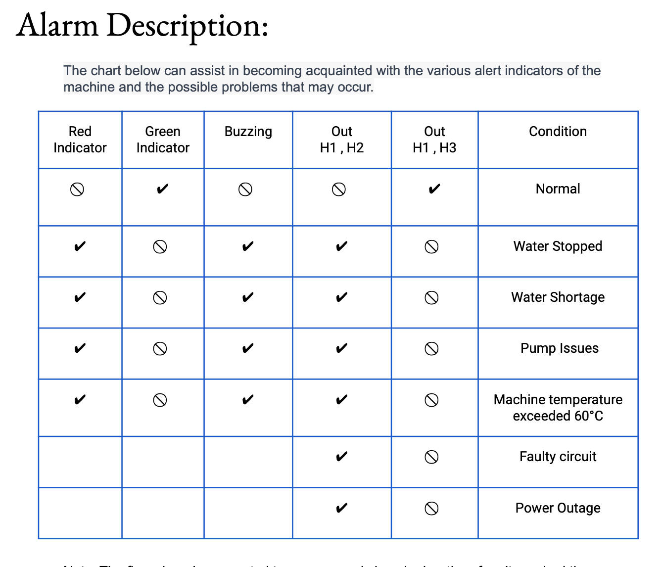

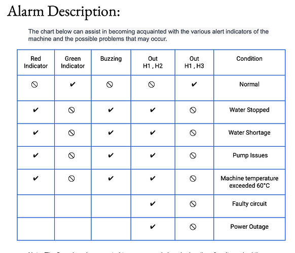

cw-5000_5200_industrial_chiller_maintenance_manual.pdf.txt (1.5 MB)
CW-5000-5200-Chiller-Manual.pdf.txt (390.6 KB)

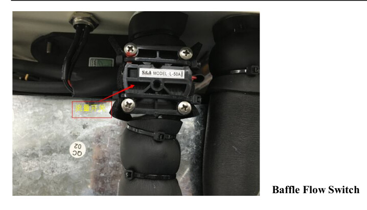

The flow sensor on my OMTech China Blue has a pressure sensor, not a flow sensor.
Maybe these manuals on the 5000 series chillers will help you locate the issue. I don’t remember what the insides really look like anymore.
This image is from the maintenance manual.
Good luck.
…this is also helpful reading
Interesting… Hall effect sensor isn’t located there on my machine, however downloaded … thanks.
That is very helpful. I will do these tests and let you know how it comes out.
