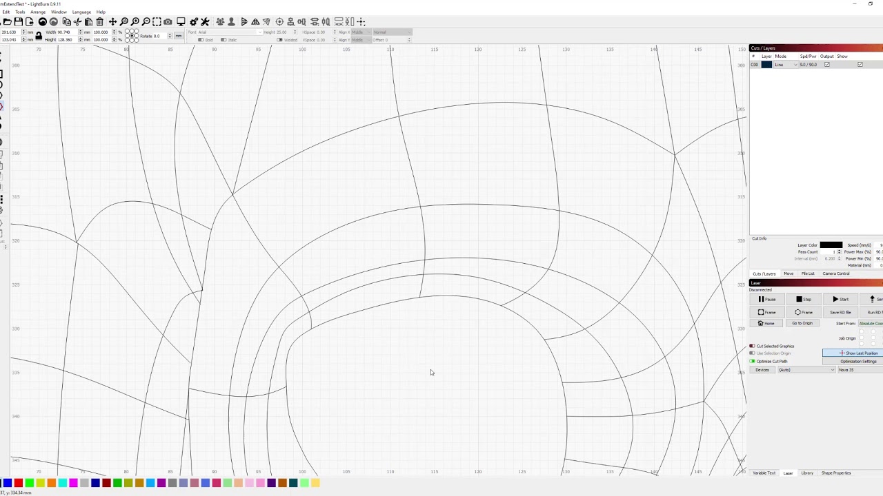

Point the mouse at the ‘Edit Nodes’ button and press F1 to bring up the help on it. Check the ‘Trim’ (T) command.
Or maybe you mean a tool like this? :slight_smile:

@adammhaile thanks for the response. I also have a CNC machine and use Vectric’s VCarve Pro. It has the ability to cut a line between two vectors which is much easier than having to go into Node Edit Mode, separate the line then remove it and join the other ends. Unless I’m missing a trick?
Ah, yes - you want the Trim function of Node Edit. There’s a demo going over how to use it here:
Your work is done!
This is a game changer for me. Thank you so much Adam.
