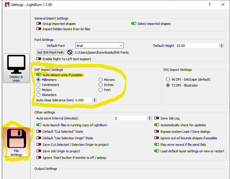

Thank you Oz, all drawings I have are, or can be converted DFX… here are three LightBurn setting: settings, device settings & machine settings; I don’t see anything there about import units, or ‘auto detect; drawings are in inches and LightBurn is set in inches. Please clue me (~:
Edit > Settings, File Settings page:
