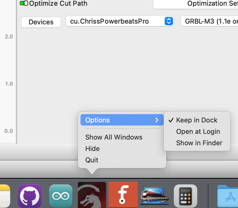

Also you can open another LB window by Right clicking the LB icon on the computer task bar at the bottom of your screen…
Opening multiple instances on Mac works differently. It can be accomplished but with a little fuss. Using the File menu is the most straightforward for most users.

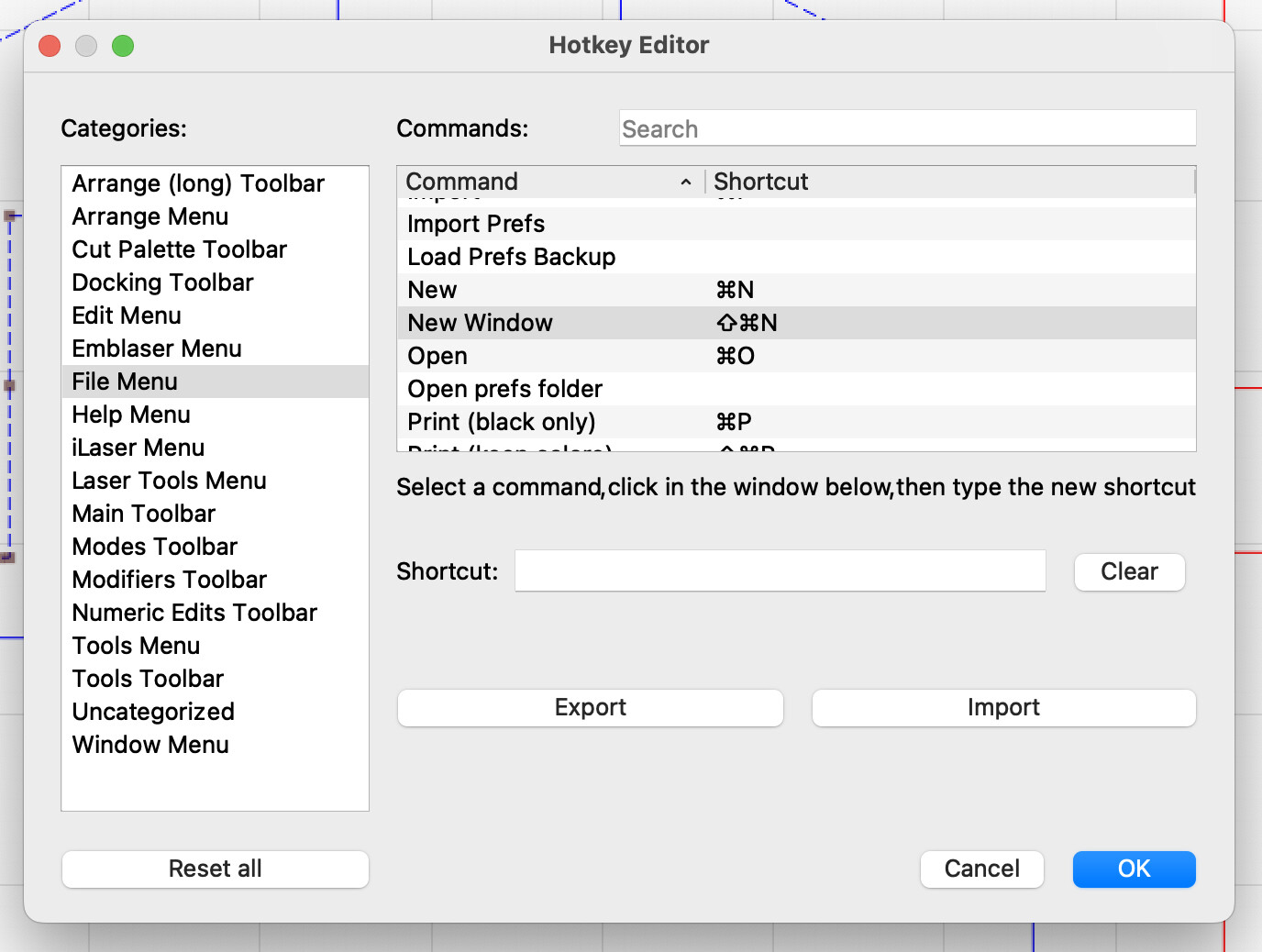

So, I found an option to assign Keyboard Hot Keys in LB.
Go to Hile > Hot Keys. I assigned CMD + SHFT + N to New Window and now I have a quick way of opening a new instance.
