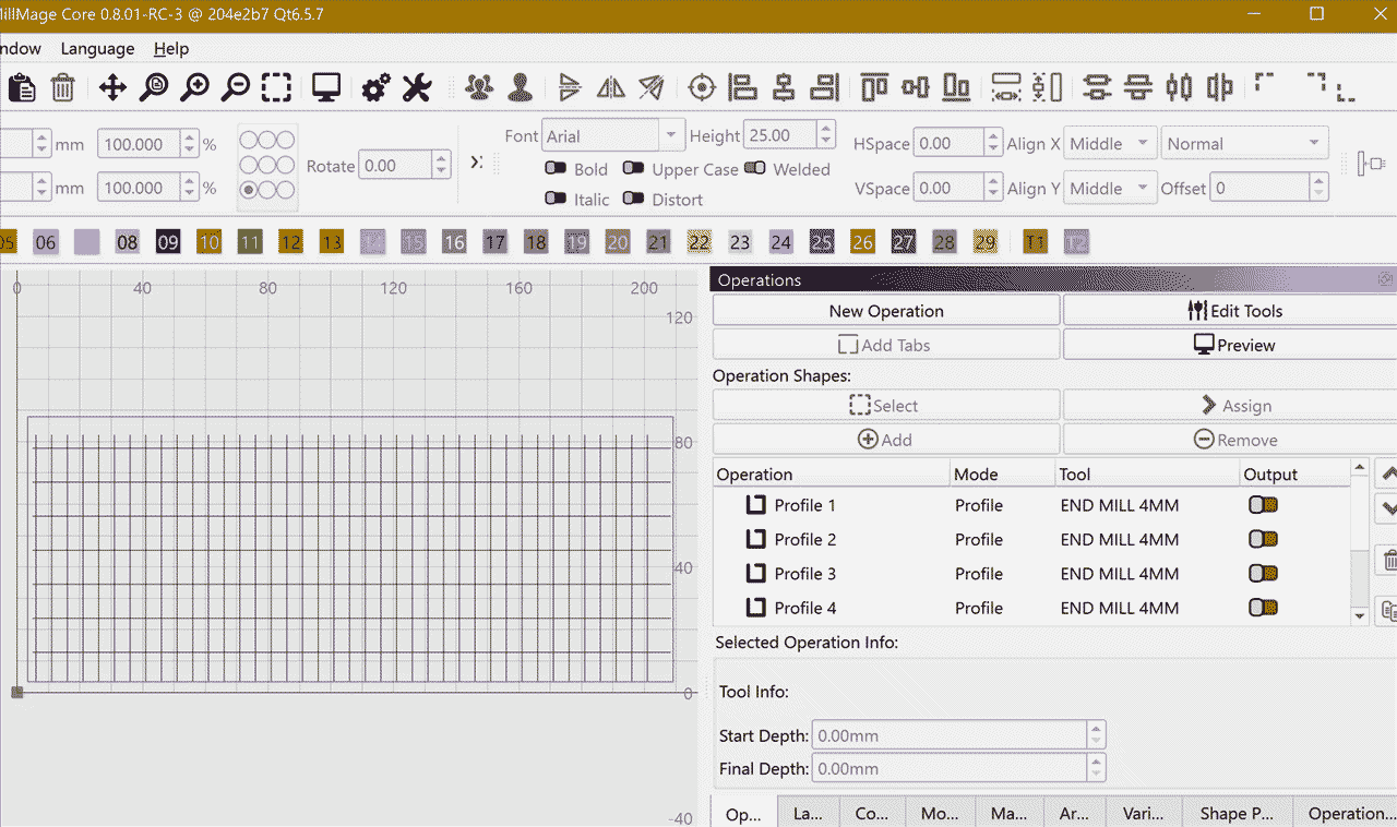

when i select profile 4 in the operation window, then click on the “select” tab ( select shapes in this operation) and then click “remove” tab (remove selected shapes from this operation) the resulting action does not remove selected shapes? windows 11

The Profile 4 OP shapes are grouped, you have to ungroup them first.
Ungroup_shapes__
ok thanks thanks for the info, i added them to the operation after grouping, thanks again
