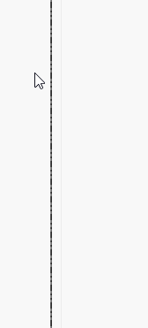

Are you absolutely certain that the pieces are directly adjacent? Have you experimented with the Distance parameter for “Remove overlapping lines”?
This is white line to the right of the cursor in the preview image above. This is at the maximum zoom possible and you can see the dashed selected object (the bottom left most outline) is directly on top of the one to it’s right (bottom 2nd from left).
I MIGHT be able to redesign the object to be .1mm larger I suppose but there isn’t an exact coordinate system that I’ve seen in LB. I’m used to programs like InDesign that have a grid snap coordinate system with a 0.001mm accuracy.

I think what’s happening is that there are still some shapes that are not directly adjacent. You can resolve this a few different ways:
  1. increase the Distance parameter for “Remove overlapping lines”
  2. redo the snapping to ensure that they’re properly adjacent
  3. recreate the shapes using grid array and setting 0 distance between each set
I’ve run a test that seemed to resolve the overlapping line scenario.
